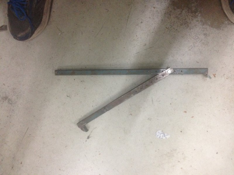

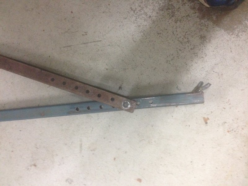

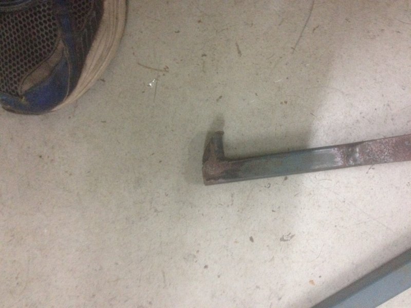

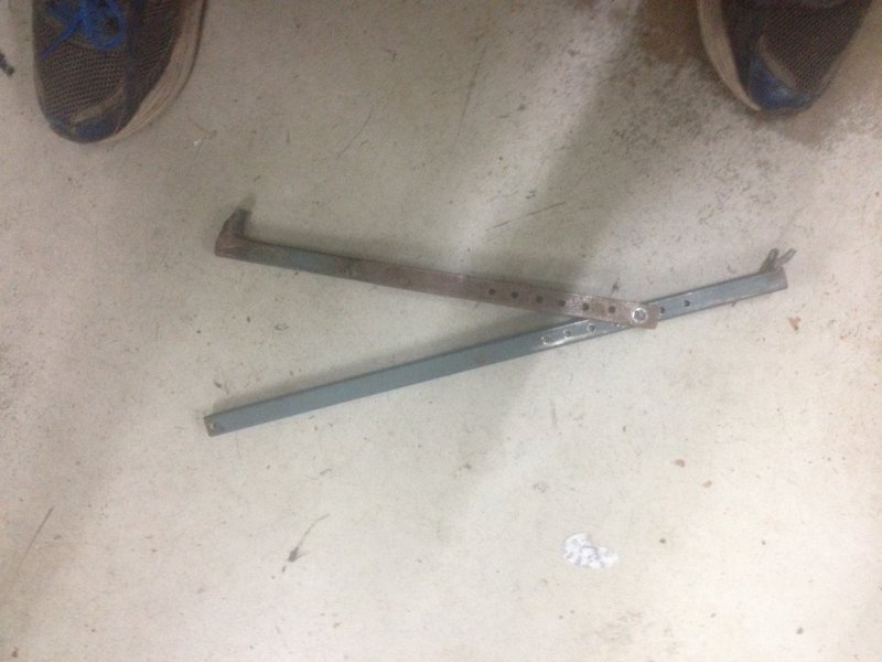

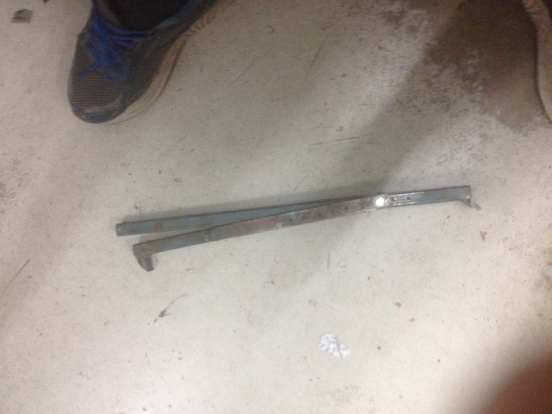

Kyle Communications Posted October 13, 2015 Posted October 13, 2015 It is really easy to make one and makes it so easy to change with the engine in place

keith.b Posted October 14, 2015 Author Posted October 14, 2015 It is really easy to make one and makes it so easy to change with the engine in place[ATTACH=full]38636[/ATTACH] [ATTACH=full]38637[/ATTACH] [ATTACH=full]38638[/ATTACH] [ATTACH=full]38639[/ATTACH] [ATTACH=full]38640[/ATTACH] I see, very handy tool, I assume it sits in the top of the leg then hook under bungee pull up? good idea. Regards Keith

Kyle Communications Posted October 14, 2015 Posted October 14, 2015 That tool looks pretty easy to make Mark - probably even in my capabilities! It is super easy to make Marty and works a treat. Just 2 bits of 19mm sq tube and 2 bits of 19mm flat then weld the flat as side frames and drill some holes. The hardest part to make is the little hook on the end made from a piece of round steel. You just heat it up til it glows then using a rod make a lip on it. This holds the bungee and stops it coming off when fitting. You just need to make a fork or some arrangement so that the top of it hooks over the middle top of the engine mount frame. This goes in behind the engine and you can remove and fit a new bungee with ease Mark
