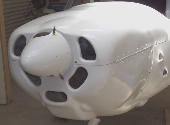

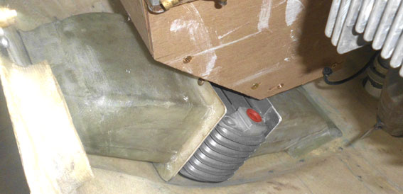

Oscar Posted November 7, 2015 Posted November 7, 2015 OK, here's a few piccies of what we've done so far - and it's all VERY theoretical at the moment, but I am taking advice from someone with a lot of useful experience. (paint isn't even hard enough yet to give a cut and polish, so please excuse the, ahem, ' average' nature of it). First: the lower cowl oil cooler intake, 'trough' to fit, and exit ( which will need an additional extractor lip but we'll do that through experimentation) Oil cooler is a 7-row Aero-classics. This is how that earlier piccy of the cooler with the ducts attached fits: ( obviously, that's a dummy sump on my 'dummy' engine I use for development of the installation). The ducting dimensions are intended to achieve some pressure recovery through the cooler matrix; they're not perfect for dimensions or shape, but not wildly far off either. The overall cowl pair is fairly different from standard LSA55, as you can see: I've tried to get the head intakes to capture more of the prop-wash from a bit further out on the blade than the standard ones, to feed the head cooling plenums, while the second (lower) set of intake nostrils ( which are WAY bigger than they will need to be, but again, we'll cut back by experimentation) will feed individual plenums for the barrels each side, which will ( probably!) have nasa under-barrel baffles as per the 'in-line air-cooled engine' research paper. There's an obvious influence on the overall design from the old Navion-style intakes, which are generally though of as fairly good for purpose. The new spinner is almost, I think, as large as yours! 1 1 3

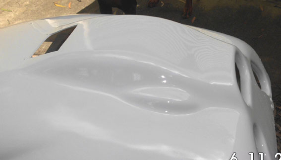

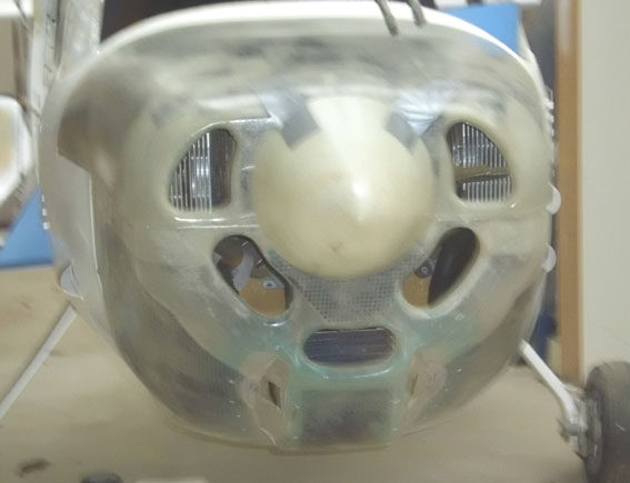

Oscar Posted November 7, 2015 Posted November 7, 2015 Actually, from dead ahead, it's more Munch's 'scream', to me: (this is the first test pull off the moulds, in polyester and using some Bunnings ute mat as a stiffener) - I think of it as the next evolution of a 'Howl Cowl': We're going to use the 'long flange', so it's 50 mm longer than a standard LSA55 cowl. Our original cowl was designed for the 1600 engine, and then 'modified' to be used as the test mule for the 2200 - and it was a dog's breakfast. Rubbing on no 1 head and rocker cover; too tight for the exhaust tubes and muffler which had severe charring ( bloody wonder it hadn't caught fire, actually). Was hugely more work than I anticipated - not from the changes to the intakes etc. but because the original ( very, very early LSA55 moulds - ours is airframe #50) were rough as guts, to be honest. Naively, I made the moulds accurate - and then found that there is as much as 10mm difference in the fuselage in various places, side-to-side, so had to do a whole heap of work to blend in the shape to the actual fuselage. As you can see in the previous piccies, we're using piano hinge to join the sides of the top and bottom cowl, which necessitates a pretty straight run for the hinge-pin - the original LSA55 cowls are very pinched-in, and held together by simple over centre catches. We've gone for camlocs for the top cowl for both speed of removal and an easy visual check of security on the D.I. - 6 at the back and two at the front, and with the hinge-pins inserted, the whole assembly is gratifyingly rigid. Made using 1.5mm Coremat and lc3600 resin with 25% aluminium trihydroxide on the final inner layer for fire-resistance, has come out about 1.5 kgs heaver than standard. Found - fairly recently, and OF COURSE it necessitated more work in fettling the cowls - that the firewall is not particularly accurate in location, and the engine offset was nowhere near the 1.5 degrees of modern Jabs. Whether it came out of the factory like that or has been subsequently 'repaired', I can't tell from the logbooks, though I have a sneaking suspicion that the latter is the case. However, IF it is 'factory', that would explain some of the 'nervousness' for landing LSA55s, since power application in the final stages of landing plus the small tailfeathers (which we've also replaced..) would cause the things to squirm. We've done a great deal of work in both repairing the crash damage and just upgrading things, and I have to admit that the early Jabs were really quite rough in construction - and yet, a vast number of them are still faithfully serving their owners. For whatever sins people wish to lay at Rod Stiff's feet, when you really get into the nitty-gritty of the things - down to cutting up the original mainspar laminations as we have done to manufacture new rear drag stub-spar fittings - you simply have to have admiration for the way in which he developed a philosophy of 'cheap, simple, safe and effective' structural design and construction methodology and carried that through into a hugely successful commercial venture, by the standards of the industry. I'll fly in ANY Jab happily, no matter how old. About two weeks ago, I had a long session of examination and discussion with the owner of an almost brand-new J170D - and honestly, the fit and finish was really, really classy. It was like looking at a Honda S2000 by comparison to a Bug-eye Sprite of our aircraft, I nearly slipped and fell on my own drool. People get carried away with what George Markey called 'the paint': assuming that the final finish they see is a mark of quality throughout. However, the lineage of Jabs. is proof that what lies underneath is 'quality' as seen by an engineer - not 'quality' as perceived from the fabulous images in the glossy brochures. 2

bexrbetter Posted November 7, 2015 Posted November 7, 2015 I think of it as the next evolution of a 'Howl Cowl':[ATTACH=full]39231[/ATTACH] Holy Cowl! 1
