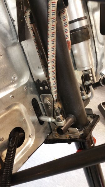

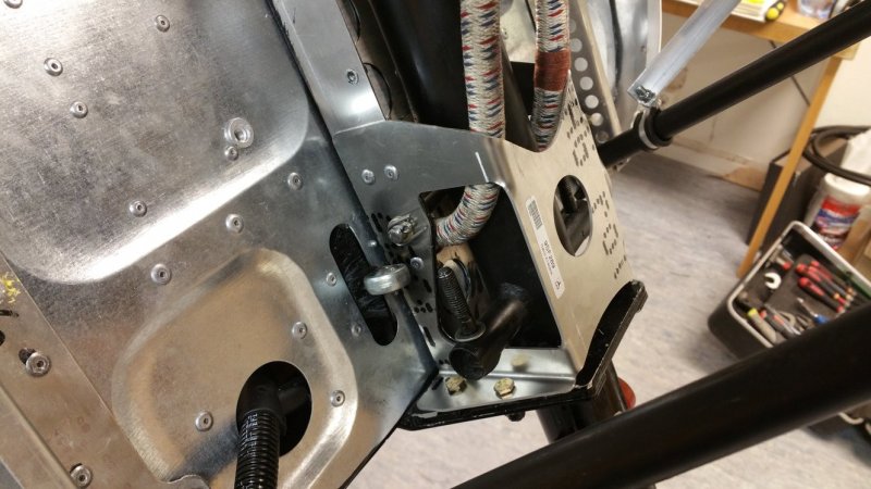

Skee Posted October 25, 2015 Posted October 25, 2015 Is the plastic plate in the lower support bad? the one clamped between two plates? There is also a upgrade for it. Is the wheel bearings bad? What is your Tire pressure?

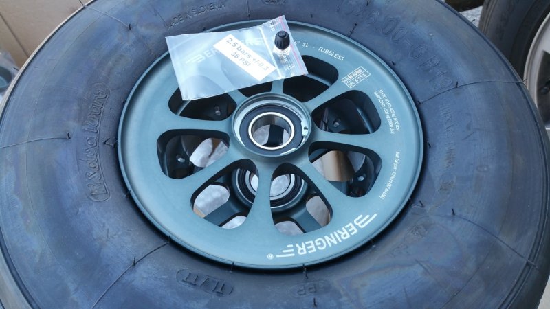

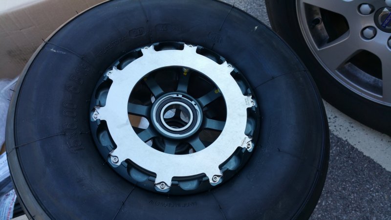

Skee Posted November 4, 2015 Posted November 4, 2015 ICP has the upgrade and tire pressure should be 0,8 bar i think.. If you have the Cash and want premium tires and wheels you can buy the Beringer wheels/tires, awsome quality. http://www.beringer-aero.com/ i did, but Premier cost allot,
erd72 Posted November 6, 2015 Posted November 6, 2015 I had the same problem, - Put the sav on the tail slider, normally if your plan is balance it will stay like that - Deflate the tyres and make a "massage" of the tyre to be sure that the tube is at the right place then reflate at 0.8 b if you can make a balance of the complete wheel - Check the bearings wheel - Check the upper fitting of the suspension arm (if you have too much gap it can also come from some cracks in the firewall) - Check the sliding of the suspension arm, the gap is less than 1 mm. You can reduce bu de / re sassembly of the plate. -Check also the fitting bolts and nuts of the fork If you don't need bush tyres, you can also use another tyre like 6x6 airtrac I hope it could help you.

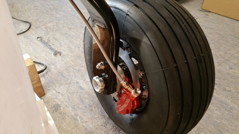

Ultralights Posted November 7, 2015 Posted November 7, 2015 the bolt heads should't hit the tyre at all. if they are, the tyre is to tall for the axel location. usually when installing bigger tundra type tyres, the axel has to be moved down a few centimetres.
