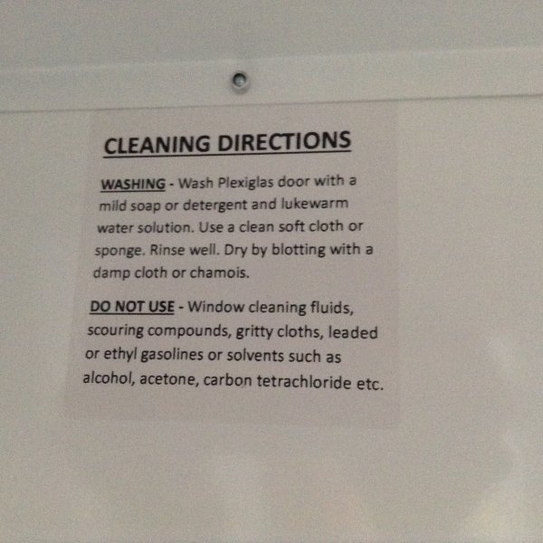

DrZoos Posted October 27, 2015 Posted October 27, 2015 I though ammonia and perspex where fatal enemies. I worked today at a place that has perspex lockers and they have a sticker on them that say, no amonia based cleaning products.
Stewy Posted October 27, 2015 Posted October 27, 2015 Novus polish works well can use with a electric buff if you want make sure it variable speed though and start slow If it is polycarbonate like head lights are made of you can use wet and dry starting at 600 and work your way to 2000 and then use fine polish to finish Stewy
DrZoos Posted October 28, 2015 Posted October 28, 2015 Another set of plex lockers a different sticker. Window cleaning fluids tend to be ammonia
Dieselten Posted October 30, 2015 Posted October 30, 2015 Novus No. 1, Novus No. 2, Novus No. 3, or Craftex Plasti-Polish, or Meguiars No 17 Plastic Cleaner. Brasso is good but contains ammonia which can adversely affect some plastics. Test an inconspicuous area first if you are going to try using it. All the others are perfectly safe on pretty much all plastics. They contain finely-divided Diatatomaceous Earth in a light hydrocarbon carrier with waxes. Clean the scratched area well before applying polishes etc. 1
