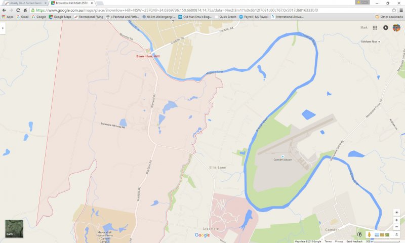

Roundsounds Posted October 29, 2015 Posted October 29, 2015 The Telegraph has reported a light aeroplane has made a forced landing in a paddock near Camden at Brownlow Hill. Nil / minor injuries and seems to be a Liberty XL-2 VH-CZS, grapevine says control system issues.
old man emu Posted October 29, 2015 Posted October 29, 2015 Local Camden flying school plane. Brownlow Hill is within the Camden circuit area. OME
JEM Posted October 29, 2015 Posted October 29, 2015 From the Macarthur Chronicle Thursday October 29, 2015 1:03pm Peter Way Macarthur Chronicle Camden A light aircraft has been forced into an emergency landing near Camden airport at about noon today. The aircraft lost engine power and had to make a forced landing at Brownlow Hill, Camden police said. The plane came down about 2.5km west of Camden Airport. Emergency services are at the scene. Camden Police crime manager Detective Inspector Jayne Doherty said she believed no one was killed in the crash. “The plane has been reasonably damaged,” she said.
