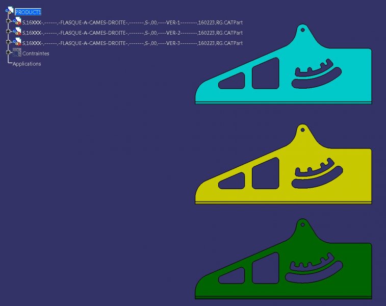

erd72 Posted February 25, 2016 Author Posted February 25, 2016 I design differents new flap positions, looking forward to test in real conditions...

Kyle Communications Posted February 26, 2016 Posted February 26, 2016 1st stage of flap for the Sav is perfect. I reckon we need another stage between first and full flap. Whe I get a chance I am going to fit a new position on mine. Just that little bit more flap would be perfect. It is well known that full flap is too course on a short takeoff. Many Sav flyers have come to grief using full flap on takeoff.
dan tonner Posted February 26, 2016 Posted February 26, 2016 I design differents new flap positions, looking forward to test in real conditions...[ATTACH=full]41673[/ATTACH] Hello Eric; beautiful videos and a handsome airplane. Regarding your flap position comments: You might wish to check out Mark Kyle's thread (Kyle Communications). On page 20 of his build thread you'll find some discussion and some design work he has done with the flap lever support plates. Engaging full flaps with the stock setup requires a forearm and wrist motion to pull the lever straight back towards the pilot's crotch. Mark has been able to incline the lever further forward in all positions with repositioned slots, detents and the lever pivot point. No other modifications are needed other than fabrication of new flap lever support plates. Fly Safely, CanadaDan
erd72 Posted February 26, 2016 Author Posted February 26, 2016 Thanks Eric, that clears it up for France.Still not sure about Italy ? Cheers PHIL I think it is the same rules in italy than in france
erd72 Posted February 26, 2016 Author Posted February 26, 2016 Hello Eric; beautiful videos and a handsome airplane.Regarding your flap position comments: You might wish to check out Mark Kyle's thread (Kyle Communications). On page 20 of his build thread you'll find some discussion and some design work he has done with the flap lever support plates. Engaging full flaps with the stock setup requires a forearm and wrist motion to pull the lever straight back towards the pilot's crotch. Mark has been able to incline the lever further forward in all positions with repositioned slots, detents and the lever pivot point. No other modifications are needed other than fabrication of new flap lever support plates. Fly Safely, CanadaDan Hi Dan I will have a look on it ! The topic of the new plates is to creat a 3 dr position with more flaps to have less rolling (i expect close around 25 m with a short final 60 km/h, no wind, no breaks) in landing and more drag (first position from the right on 3 rd design plate). The "no flap" position in reality is close to negative flap position, to increase the cruising (i expect more than 10 Km/h)
eightyknots Posted February 26, 2016 Posted February 26, 2016 Hi Dan I will have a look on it !The topic of the new plates is to creat a 3 dr position with more flaps to have less rolling (i expect close around 25 m with a short final 60 km/h, no wind, no breaks) in landing and more drag (first position from the right on 3 rd design plate). The "no flap" position in reality is close to negative flap position, to increase the cruising (i expect more than 10 Km/h) It is an interesting concept but are there any other planes that fly successfully with 10 degrees negative flap?
erd72 Posted February 26, 2016 Author Posted February 26, 2016 in Flap 0, savannah have still Flaps' drag. So it doesn't mean that i will have ten deg negative. The design of the 2 first is + 10 ° at the handle, the 3 rd one is 12 ° but at the handle, I need to check the value at the flaps. Yes, i know one who made this kind of modification with sucess
rankamateur Posted February 26, 2016 Posted February 26, 2016 creat a 3 dr position with more flaps to have less rolling (i expect close around 25 m with a short final 60 km/h, no wind, no breaks) I have measured an 18m landing roll on a VG. It landed across my airstrip! http://www.aerokits.net.au/ the video is second to last at the bottom of this page. 1

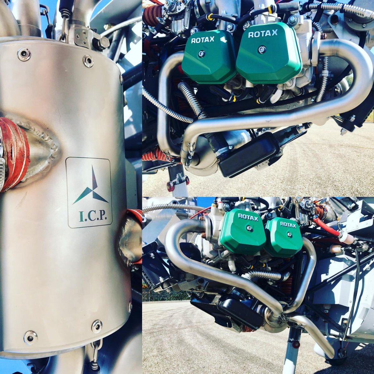

erd72 Posted July 29, 2020 Author Posted July 29, 2020 Hello, I did a last evolution on my savannah, fitting an injection system with a lambda control. testing in progress... Next step will be changing the electronic ignition for programmable one, and trying to find a good and efficient exhaust, does anybody knows one we can fit easily to change the ICP's one ? Thank you !
Kyle Communications Posted July 29, 2020 Posted July 29, 2020 Hi Eric sorry to say there is no off the shelf exhaust for the Sav at all. The current std exhaust chokes the engine and makes one side run hotter than the other. You could retrofit a 912IS muffler with new pipes but you need to modify the lower cowl. I have done some work on converting a standard Rotax muffler but have not modified a cowl yet There are a coule of us here playing with a new exhaust straight through without a muffler it connects 2 cylinders into one pipe then the other two into another pipe then those 2 pipes converge into one pipe. The whole assembly is tuned and should give around 5 or so extra horsepower..it maybe load though and a inline muffler maybe needed under the front floor of the Sav
erd72 Posted July 29, 2020 Author Posted July 29, 2020 o thank you, there is a company in france which makes one with a muffler under the airframe (SILENCIEUX Echappement Avion SCAI TECH SILENCER) but I would like to keep the muffler under the engine. I will send some pictures and dimension to CKT exhaust in england to ask them if they have any solution...
Kyle Communications Posted July 29, 2020 Posted July 29, 2020 Hi Eric have a look at my blog here Another NEW Savannah XL on its way from post #886 this has what I did with the std rotax muffler. It had more power on the ground but I didnt get the new lower cowl finished....I may do as I have a mold of the lower cowl now to be able to make a new one. I am not too far away from fitting the engine to my latest project My Savannah S model rebuild Blog
erd72 Posted October 26, 2020 Author Posted October 26, 2020 Hello, Does any have already tested or have some information about the new termignoni exhaust (volume mluffler for example) ? Will be serial for each savannah and ventura from november..
Kyle Communications Posted October 26, 2020 Posted October 26, 2020 Have not heard about it. I just did a search and its mainly for Motorbikes
erd72 Posted November 3, 2020 Author Posted November 3, 2020 Ok wait and see, we will probably one for testing within 3 weeks...
Kyle Communications Posted November 3, 2020 Posted November 3, 2020 This is from the ICP facebook page..it was on the other day
IBob Posted November 3, 2020 Posted November 3, 2020 Aha. Not before time! And airscoop for heater on front of coolant radiator too...
