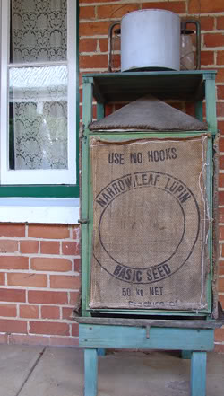

old man emu Posted November 10, 2015 Posted November 10, 2015 Nev, How about adapting the concept of a Coolgardie Safe? https://en.wikipedia.org/wiki/Coolgardie_safe OME 1

RichTee Posted November 10, 2015 Author Posted November 10, 2015 Just did a rough calculation for Density Altitude using this data: Airport Altitude 5000, QNH 1024 OAT 45C Rel Hum 10% and this gives a Density Altitude of about 9000 ft. Can this be a cause of poor performance, or are you noticing vapour locks?OME Hi Old Man Emu, Thanks for the info....will download those PDFs and have a read. My main concern (in this thread) is the fuel system with high ambient temps. The performance was just fine (operating from a low strip at 1,500 agl...so density alt was fine)....but a vapor issue at 200-300 ft agl would not be fun !!! I like your Coolgardie Safe....was discussing this am...and we recon we will fly the morning session...leave the airie with low fuel in her...and only fill the tanks again for the afternoon session just before flying...and ensure its from a cool source. That should help. We are also looking to switch to AvGas during the hotter months. Cheers, Rich 1
