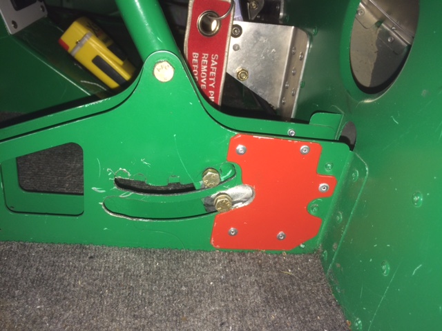

Kyle Communications Posted November 15, 2015 Posted November 15, 2015 Another reason Ultralights I am about to modify my modified flap bracket again. My full flap will be just under half way between first stage and full flap. It should become far more useable than it is now...because now I never use the original full flap and I think it will be much better to have just a bit more than the original first stage. and first stage will also become just a little bit less than original. Mine still have the factory flap positions but the flap handle is in a different position so I can easily use it 1

erd72 Posted December 18, 2015 Posted December 18, 2015 Another reason Ultralights I am about to modify my modified flap bracket again. My full flap will be just under half way between first stage and full flap. It should become far more useable than it is now...because now I never use the original full flap and I think it will be much better to have just a bit more than the original first stage. and first stage will also become just a little bit less than original. Mine still have the factory flap positions but the flap handle is in a different position so I can easily use it I am working on flaps positions onf my savannah s , creating 1 more position for full flaps, and 1 position negative flaps. So 5 positions. I expect an increasing speed around 10 Km/h, and shorter land distance for very short tracks (lenght less than 80 m). A pict of the concept done by a friend
facthunter Posted December 18, 2015 Posted December 18, 2015 Flaps do good things add lift, lower the nose and add drag. Good on approach but not good on climb. Nev
eightyknots Posted December 18, 2015 Posted December 18, 2015 I am working on flaps positions onf my savannah s , creating 1 more position for full flaps, and 1 position negative flaps. So 5 positions.I expect an increasing speed around 10 Km/h, and shorter land distance for very short tracks (lenght less than 80 m). A pict of the concept done by a friend I wonder if the negative flaps will really increase speed by 10 km/h?
erd72 Posted December 18, 2015 Posted December 18, 2015 On VG XL it seems to be at least 10, 12 ... But i will test in january...
