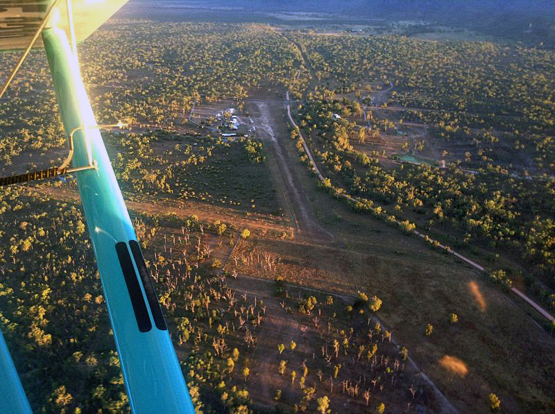

Garfly Posted December 2, 2015 Share Posted December 2, 2015 A shot of Starke Field posted here by Ross himself just a couple of months ago. http://www.recreationalflying.com/threads/guess-the-airstrip.151/page-34 2 Link to comment Share on other sites More sharing options...
Teckair Posted December 2, 2015 Share Posted December 2, 2015 Does anybody know which way he was taking off? Link to comment Share on other sites More sharing options...
bull Posted December 2, 2015 Share Posted December 2, 2015 Does anybody know which way he was taking off? He was taking off to the north evidently,or so I,ve been told, which on that photo is towards the small cross strip.which I have taken off many times in the same lightwing I think it used to be owned or leased by Pat Magrah [not sure how to spell his name]I did my first 10 hours dual here with him,and the north has a few options and just out of the photo to the north is cane fields,,,,So to it seems strange to me that he would have tried the turn back,,,might have had too much angle of attack when the donk stopped and as this lightwing has a speed wing it stalls quicker than the lightwing that Ross has flown for years.cause being just to side of the strip this aircraft could have caught him out and just stalled maybe ???My comments earlier about the gum trees that used to scare me is taking off to the south! 3 Link to comment Share on other sites More sharing options...

Guest ozzie Posted December 2, 2015 Share Posted December 2, 2015 Now I've seen that photo of the strip it makes me wonder even more why he turned back. Link to comment Share on other sites More sharing options...

dan3111 Posted December 2, 2015 Share Posted December 2, 2015 A shot of Starke Field posted here by Ross himself just a couple of months ago. http://www.recreationalflying.com/threads/guess-the-airstrip.151/page-34 Golly By that photo the general circuit area is a lot of big prickles it doesn,t look to friendy for any testing out of there ,you would need a post at the end of the strip to run engine at full power for 10 mins before taking off . Just a dumb question which way does the strip run and where was the sun been taking off that time of morning . Link to comment Share on other sites More sharing options...

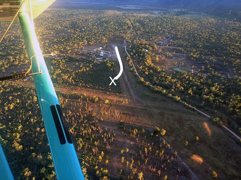

frank marriott Posted December 2, 2015 Share Posted December 2, 2015 5 Link to comment Share on other sites More sharing options...
David Isaac Posted December 2, 2015 Share Posted December 2, 2015 Dear God, that doesn't make any sense at all. 10 Link to comment Share on other sites More sharing options...
bull Posted December 2, 2015 Share Posted December 2, 2015 From that location of accident ,it looks to me more and more that the aircraft has stalled in climb and fell to the right ,rather than an attempt to turn back. Might have been trying for the cross strip,i guess we will never know. Was a pleasure to know you Ross,and the world has been made a better place by your presence,,blue skies mate and RIP. 1 1 Link to comment Share on other sites More sharing options...
farri Posted December 2, 2015 Share Posted December 2, 2015 To be sure, I was about to ask Frank if the x was where it crashed. Leaves me shaking my head, wondering just what did happen! 6 Link to comment Share on other sites More sharing options...
bull Posted December 2, 2015 Share Posted December 2, 2015 Dear God, that doesn't make any sense at all. I agree 100% with you David, it makes no sense at all with all that clear area in front of him, Idid not like training there with all the tiger country around the strip. 1 Link to comment Share on other sites More sharing options...
