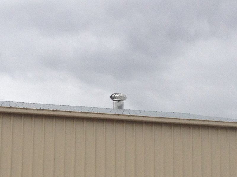

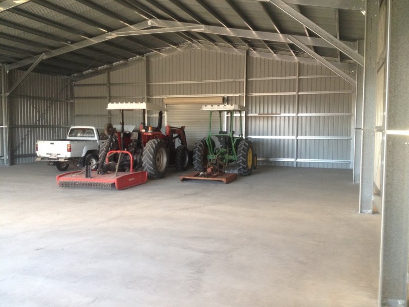

rankamateur Posted December 2, 2015 Posted December 2, 2015 You don't need 4m to fit a Savannah, but it makes a more useful shed of it. Mine has two tractors, a round hay baler and a spray rig in it as well, so make it a useful height. Mine is 4.5m eave height and 3.9m through the side roller door and about 4.3m at the sliding doors on the gable. One or more whirly birds have blown off it three times now (buy the dear ones!), but the shed hasn't looked like blowing away. It is positioned with a solid sheeted wall towards the prevailing south westerly of the nasty storms, I think that is important.

Kyle Communications Posted December 3, 2015 Posted December 3, 2015 One or more whirly birds have blown off it three times now (buy the dear ones!), but the shed hasn't looked like blowing away. Well I have 4 of the expensive whirlybirds..they didnt blow off 3 weeks ago but the spun that fast they crushed themselves and tried to spin out of their bearings...all 4 whirlys on my hangar are the same

rankamateur Posted December 3, 2015 Posted December 3, 2015 "..because I'm having to build the Sewing Room for the Missus before I can build the plane".Geez no wonder you Blokes get into strife. No go these blokes. I built mine in Mum's lounge room as I have said before. [ATTACH=full]39749[/ATTACH]Well I have 4 of the expensive whirlybirds..they didnt blow off 3 weeks ago but the spun that fast they crushed themselves and tried to spin out of their bearings...all 4 whirlys on my hangar are the same Mine are the same as yours Mark. The expensive ones I referred to have a square profile head and were $473 each for the 450mm size I used three of. Mine were coming of the roof flanges and bouncing around the paddock. Latest one came apart where the black plastic frame bolts to the swivel base. I don't remember other (300mm) ones I have use in the past having plastic frames. They have panel beaten successfully so far but a couple have needed to be stripped down and straighten the aluminium axle up the middle depending how they landed. Old angle of arrival argument again, they land better when the wind is stronger.

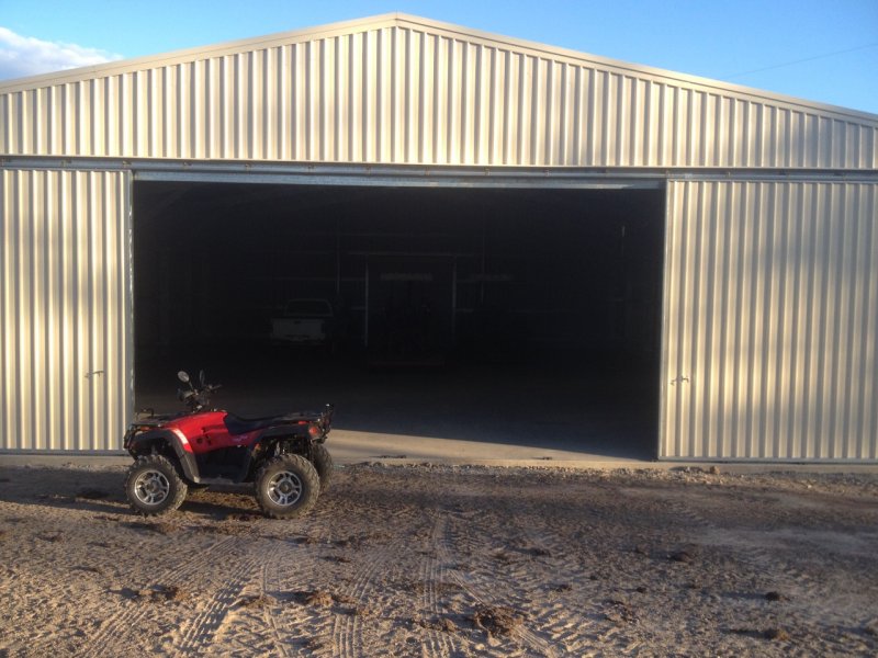

Traveldoc Posted December 4, 2015 Author Posted December 4, 2015 I had no dramas with the council with mine. It was put up as a "machinery shed" 270 sq m. The inspector asked why it had sliding hangar doors. I said to him well if you can lift a 15 mtr wide roller door dude you can call it that The shed needs to be lockable and I cant rely on power as we are on a SWER line for a motorised door. He accepted that explanation...knowing full well that it was going to be a hangar...oh sorry machinery shed Mine will be minimalist in the extreme compared to your Taj Mahal A big carport with 3 walls. No doors. I'll put some kind of heavy duty motorcycle anchor chain set into ground for security. And farm gates across the front to keep cattle out. S
