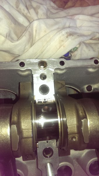

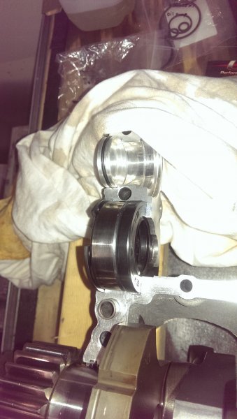

Lyndon Posted February 23, 2016 Author Posted February 23, 2016 I could not find any info on splitting the cases. Maybe you all know but case bolts studs etc is 25 nm. This seems to be secret. Cam timing is a breeze. Replace to two orings. Use three bond with a one not a two. Five dowels . Apart from that there is nothing else in the cases. Easiest thing you will ever do. Nitraded cam and hardened lifters. I don't think that works but I'm no expert. It was worn at 1740 hrs. So I'm guessing at 1000 hrs it would have been comprised. If Rotax got rid of the 1920s flat tappet cam I would not not have to do this. Lyndon

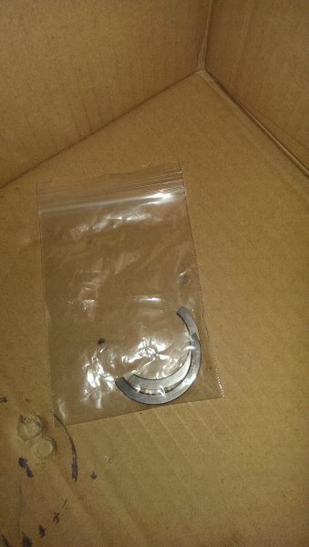

Lyndon Posted March 4, 2016 Author Posted March 4, 2016 Does anyone have a crankcase Dowell. I have lost one Lyndon Wright

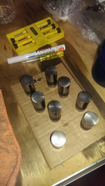

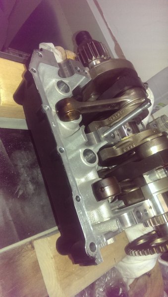

Lyndon Posted March 7, 2016 Author Posted March 7, 2016 Update. I've been waiting for a crankcase Dowell. Anyway pulled the lifters apart and cleaned them. Absolutely perfect at 1740 hrs 1

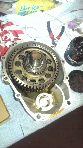

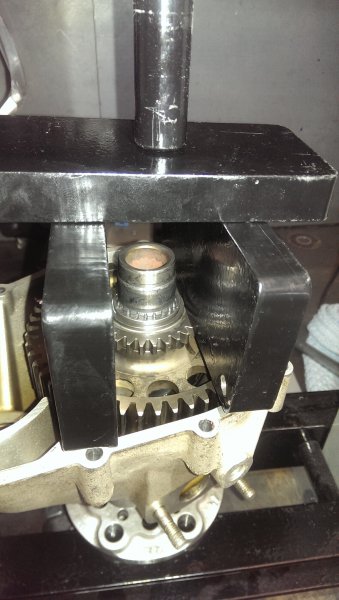

Lyndon Posted March 14, 2016 Author Posted March 14, 2016 Update. The main thru bolts are a torque to yield arrangement. Without checking 15 nm plus 180. I'm doing some research but in my industry torque to yield are one off use. I will get back to you. Ps I have to tool to remove the rear the engine if any one needs that. Also I'm about to do the gearbox service and preload. If anyone has thought of saving 600 bucks and doing it themselves. Lyndon
maulonir Posted March 14, 2016 Posted March 14, 2016 Preload for the friction torque or for the slipper clutch? Rob

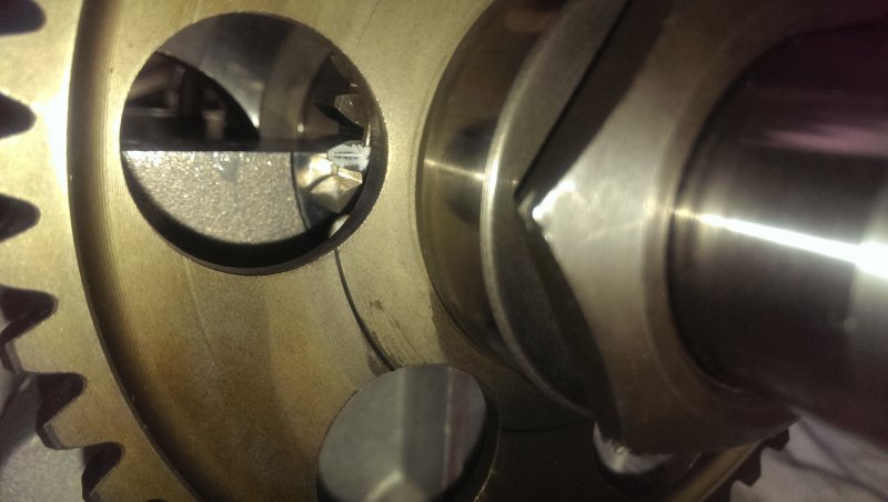

Lyndon Posted March 14, 2016 Author Posted March 14, 2016 Is .039 tho or a mil unloaded. Depress then fit halves. Easy as
Lyndon Posted March 14, 2016 Author Posted March 14, 2016 Before you disassemble. Scribe your splines with a 1 mm feeler. After cleaning and inspection, assembly with it all settled. Adjust your shims to the 1 mm Scribe. Perfect. Depress a bit over 1 mm install your new halves and it's done .
Lyndon Posted March 28, 2016 Author Posted March 28, 2016 I have done my gearbox. All was good. A bit of fiddling with the three diaphragms to line them up. seems odd the middle one can't be centered and relies on the others to keep it in place. There is some offset wear because of this. But it clearly works as it's done 1740 hrs and is in very good Nick . Can't believe the new halves were 70 dollars. I still can't assemble my engine as I have issues with cam end play. This is taking a long time to sort but hopefully by the end of the week it can be sorted. 1

Lyndon Posted May 15, 2016 Author Posted May 15, 2016 I've been a bit quiet lately. You won't believe but 17 weeks to get my cam done. I've stopped my build till I sort the engine. I had allowed about five or six weeks all up. Apparently there is unemployed people in Australia. Well when I try to get something done it takes for ever and then it's not done correctly. It's been a comedy of errors. Anyway it's now sorted. New orings in the cases. New circlip and seal. Timing Mark aligned and gear in place before cam. All five dowels in place.
Lyndon Posted May 15, 2016 Author Posted May 15, 2016 I've painted the cases in a nice Matt black. Came up really nice

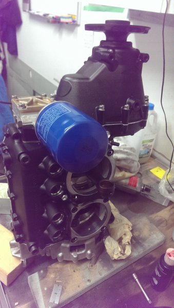

Lyndon Posted May 17, 2016 Author Posted May 17, 2016 Making some progress. I intend to prime the oil pump and fill the engine prior to fitting the top end. That way I won't wipe off all my cam lube. Then I should be able to fire it up with minimal engine turning. Lyndon 1
