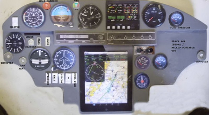

Oscar Posted January 18, 2016 Posted January 18, 2016 This is a first trial of a new panel arrangement I've been working on for our LSA55, to incorporate a full iPad (though it'll probably be an iPad Air by the time we get to install it!) Obviously, all the instruments, switches etc. are cardboard cut-outs with faces printed on them... and we've decided to cut back the 'step' around the iPad to give more shin room. We put the iPad in portrait so a track-up provides best view of the track ahead. It's a drop-in to the standard LSA55 panel mount fittings; the iron primaries and the MGL 'extreme' mini efis plus the radio and transponder sit in a reaward projecting 'shelf' that provides about 50mm of shade for the iPad. ( and yes, it's shape is asymetric so the PIC has good vision out of the rh bottom corner of the windscreen). We intend to have cut-outs in the panel behind the iPad and some air tubes pointed at the general direction of the footwell air vents for ventilation to the iPad in hot weather. There's a spot large enough for an iPad mini in front of the pax. by mounting the Hobbes on the side of the binnacle and moving the iron Oil temp. down into its location. As an old fart who needs bi-focals, I prefer analogue instruments as far as possible, so a sweep of the panel can check the needles.. but we might replace the vacuum A/H with an XAvion display. And the panel-mount dual throttles may well be not installed; I have a few ideas, but might just stick with the standard crotch-grabber set-up. Would appreciate comments from regular users of Ozrunways / Avplan.

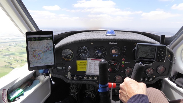

Roscoe Posted January 18, 2016 Posted January 18, 2016 iPad mini in my Jabiru 160 ..... Bob[ATTACH=full]40844[/ATTACH] Bob thats a great set-up. I have exactly the same in my Jab170 except the Ipad Mini is on the RH side and the 296 on the left. I found even the Mini too much "in my face" on the LH side but the 296 is small enough to be out of the way! 1
Oscar Posted January 18, 2016 Posted January 18, 2016 Roscoe's 170 is so schmick as to cause drool on the lips of older Jab owners (aka, me).
