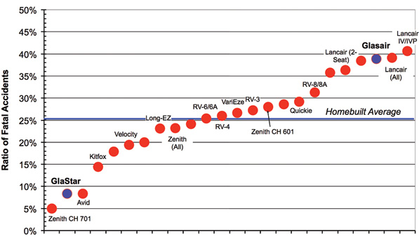

nickduncs84 Posted February 3, 2016 Posted February 3, 2016 Ah, sorry Nick, thought you were talking about Cirrus G3.. (it was late when I wrote that last night) Anyway, further to your comments, there is no correlation between stall speed and safety.. You commented on feeling safer in a carbon cub than something that stalled at 60 plus knots, yet that particular aircraft has been involved in quite a few accidents (fatal) involving what I would describe as arrival stalls. I might add that I just don't fly so called high performance planes, but also enjoy the other end of the spectrum.. for example before I strapped on a Lancair, the only aircraft that I flew during the previous 12 months was the Skyfox.. so regardless of what plane you fly, if you fly it within the design specs, you can really enjoy the experience. Looks to be some correlation to stall speed to me. I get what you're saying and agree that the vast majority of accidents are caused by pilot error, usually on the ground, but I think stall speed does have an influence. If all other factors remained constant and we looked only at stall speed, something that stalls at 60 knots has 4 times the energy to dissapate in a forced landing compared to something that stalls at 30 knots. Maybe it is irrational, but I wouldn't put my son in a Glasair no matter how much experience I had. I would put him in a cub. Like I said, I know there are many other factors that are much more likely to impact on the safety profile, but to me it's the ones I can't control that really scare me.
facthunter Posted February 3, 2016 Posted February 3, 2016 It's how you operate it. (Environment and skill) to a great extent. The Mooney has plenty of wing, bit most are a bit underpowered. The Lancair has a reputation but a lot of it is with the pilot, but it is a plane that needs sealed strips with a bit of length and not suited to outlandings in a paddock as for one thing it has tiny wheels and brakes. From memory, a Bonanza at full weight needs well over 80knots as a manouvering glide speed. Speed doesn't directly affect glide angle, but when it hits something it's got all to do with the damage to occupants. Assuming you have a small headwind, a Cub or such will be doing about 30 knots G/S and the other types double that so 4 x the energy to dissipate. (Impact for the occupants) A heavier plane might even assist the occupants to survive, especially if a lot of the weight is in front of them. Nev
