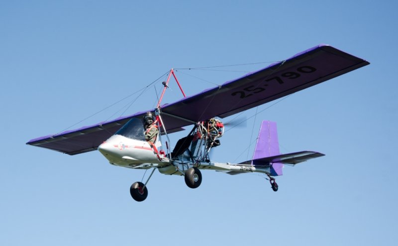

c722352 Posted January 13, 2016 Posted January 13, 2016 Been a Long time coming, the 25 hour test flying is complete, the paper work is in. Maybe soon the certificate. Then you may see her at an airfield near you. 3 2

rankamateur Posted January 13, 2016 Posted January 13, 2016 Those red tappet covers do stand out against the purple.
