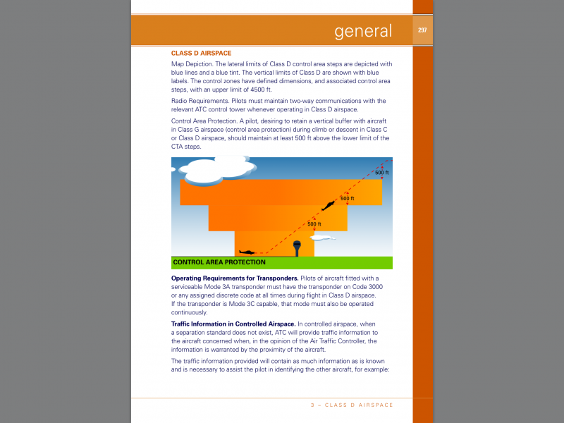

ben87r Posted January 29, 2016 Posted January 29, 2016 We were told during training that all planned CTA climb/descent profiles had to be no less than 500' above the steps. Not sure if it is something that has changed over the years tho.

frank marriott Posted January 30, 2016 Posted January 30, 2016 Quote We were told during training that all planned CTA climb/descent profiles had to be no less than 500' above the steps. Not sure if it is something that has changed over the years tho. That is in the VFG also Ben, I had 1000' in my head for some reason until I was corrected above. 1
