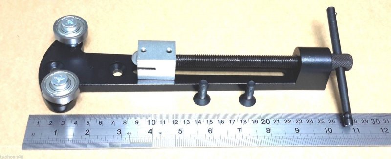

Downunder Posted January 31, 2016 Posted January 31, 2016 http://www.ebay.com.au/itm/Oil-Filter-Cutter-Heavy-Duty-Jabiru-Rotax-912-914-Ultralight-Aircraft-Engine-/331629413107?hash=item4d36a742f3
rankamateur Posted January 31, 2016 Posted January 31, 2016 Ebay vendor very kindly posted excellent photos for any one who is a bit handy. 2

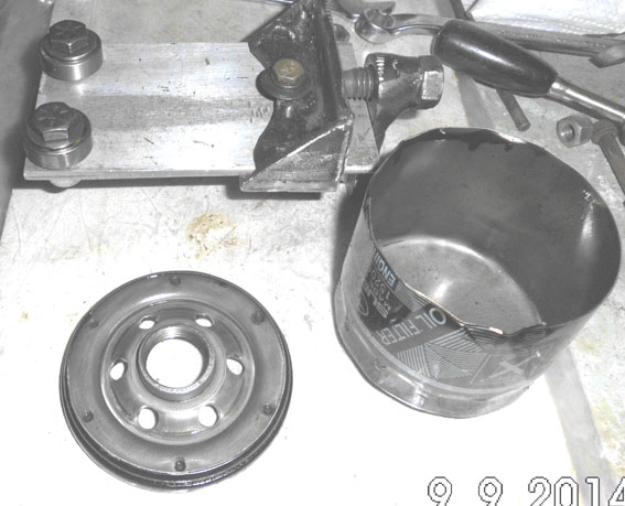

Oscar Posted January 31, 2016 Posted January 31, 2016 I made up this one using two small ball bearings and a cutting wheel from a tube cutter. Not flash, but as you can see, it works properly. ( sorry about the poor photo.) 2
