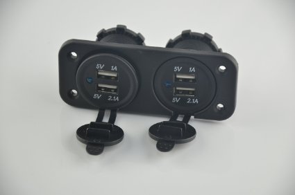

Kyle Communications Posted February 13, 2016 Posted February 13, 2016 http://www.jaycar.com.au/Power-Products-Electrical/Power-Conversion-%26-Transformation/12VDC-Power-Supplies/Dual-Port-3-1A-USB-Charger,-Panel-Surface-Mount-12VDC-Input/p/MP3616 I have 2 of these but in a flat plate side by side on my dash and a Jaycar 12V cig lighter socket a very good quality plastic style one with a great panel mount. I will see if i have any pics of them 1
Kyle Communications Posted February 13, 2016 Posted February 13, 2016 hahaha yes it is....I have a single cig plug next to that plate. When I get a chance I will take a pic of them in my dash. I thought I had some pics here on my phone but I havent
rankamateur Posted February 13, 2016 Posted February 13, 2016 I think I will drop one in place of my worst Cig lighter socket. Only need one if I have the charging covered. Need the other one for my Ag GPS.
Kyle Communications Posted February 13, 2016 Posted February 13, 2016 I use the 4 outlets I have . 1 for the Ipad mini while flying another to charge my phone the other 2 power my GoPro and Nflightcam
