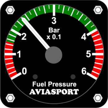

Blueadventures Posted February 20, 2016 Posted February 20, 2016 Quote Maybe Neil is meaning .4 barsorry no jimG I mean 6 to 7 bar no point before the 6 or 7 yes you are right in your spiking figures yes some off you are starting to hear me at 89.4 to 104 .3 psi in the old scale to high for this black duck what is the burst pressure of fuel line where does excess fuel go from what I am hearing Foxbat do not have back up electric pump why ?neil The Aivasport fuel pressure gauge for the 912 engines read in whole numbers X 0.1 ; 4 is 0.4 bar. 2 1 1
Geoff13 Posted February 20, 2016 Posted February 20, 2016 Quote The Aivasport fuel pressure gauge for the 912 engines read in whole numbers X 0.1 ; 4 is 0.4 bar.[ATTACH=full]41583[/ATTACH] That agrees with the installation manual. 1 1
