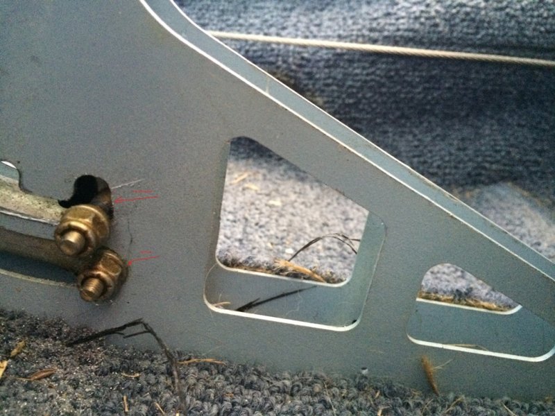

JerzyGeorge Posted February 25, 2016 Posted February 25, 2016 Hi All , Not long ago I had my flaps disengaged from full position to nothing during take off. Not nice experience , but I recovered with no damage at all . After thorough examination this is what I discovered: 1. The top bolt which is the lock-in bolt did not go into position - even with spring action . 2. I thought that flaps were locked , but as soon as I got enough air flow over the wing they slammed shut, 3. The problem is and please check your flaps assembly for: a) the bottom bolt should work as a stop bolt in full flaps position b) the top bolt should have a 1 mm clearance from the notch to allow for free movement In my case it was opposite the top bolt was working as a stop bolt and not allowing to move up because of the friction. It is something hard to detect without actually looking down there or running your fingers there ( risking nasty pinch) because on the top of the flap lever it looks OK. I do not use full flaps very often and did not notice this problem before ( having about 500 hrs.) I used needle file to open 1 mm gap for the top bolt to allow it to slide free with the bottom bolt taking full pressure. Operated on the ground about 15 times and could not fault it. I am sorry about the poor quality of the photo George 1

rankamateur Posted February 25, 2016 Posted February 25, 2016 Quote Of course my trusty Savannah VG There are two little tabs on the inner aluminium part of the flap handle. Reg was here the other day and suggested mine needed more filed off the tabs because it binds a little bit and doesn't lock in the full position unless I wiggle it. Might help yours too.

bobcharl Posted March 2, 2016 Posted March 2, 2016 Hi Jerzy, I remember during construction of my VG-XL that it appeared that the slots to accept the locking bolt were not deep enough to be secure. Your photo seems similar. I recall around that time someone else had trouble with inadvertent disengagement of the flap mechanism, so I decided to file the slots deeper to ensure a more positive engagement. Cannot remember if I widened the slot , but I do remember stretching the spring slightly to hold the bolt a little firmer into the slot. So far so good but it is relatively early days yet- only 80 hrs. to date. Could possibly organize a photo if you feel you need it. Regards, Bob
