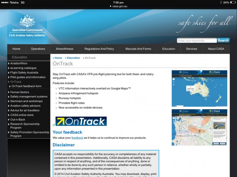

Graham Pukallus Posted March 1, 2016 Posted March 1, 2016 Check out the "On Track" section of the casa. gov.au site, for procedures and hot spots around some main aerodromes Australia wide, may be of some help.

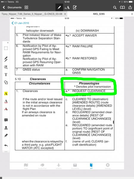

dutchroll Posted March 2, 2016 Posted March 2, 2016 From AIP. Clearances are always requested. Reports are just stated. 1
