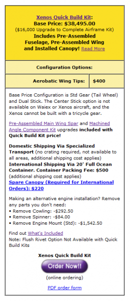

fly_tornado Posted April 9, 2016 Posted April 9, 2016 so sonex have released a new xenos quick build kit, fast way to get into a motorglider
