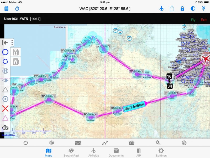

i'd like to know how the R22 boys ( and others ) can do "distant" legs etc, with retaining 45mins fuel.
( another good reason to own a jab )......003_cheezy_grin.gif.c5a94fc2937f61b556d8146a1bc97ef8.gif
Geeez.......where do i start, just point em and go. They're good for 100+kts, 6...8hrs duration, comfy,safe,..........that's 4 reasons, toss in........you find em everywhere criss crossing this island, and that's a fact.
Could go on .......but i'm packing the ol girl ( jab ) for Qld, NT, WA, Qld.........be gone for 5....6 weeks, tiger country all the way. 019_victory.gif.9945f53ce9c13eedd961005fe1daf6d2.gif
Sumthin like this....
Hi Russ
Looks like a great plan and hope you have a fantastic time doing it.
I'm planning a trip July/August from home in Vic across to Broken Hill, Coober Pedy, Ayres Rock, Warburton, Carnegie Station, Meekatharra, Cobra Homestead (my old place), then down to Perth for a conference and back home via the southern coast.
I'm going to have to carry extra fuel because there is no avgas at Warburton and I don't have the long legs you have in the Jabiru. Can't decide whether to use a plastic tank or a bladder but I won't plumb it in; just siphon into main tank on the ground at Warburton.
