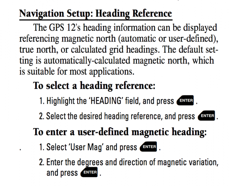

Garfly Posted March 14, 2016 Posted March 14, 2016 Hi Andy, You wrote in #31 above that "GPS generally show true bearings (mag var adjusted)" I'd always assumed that the default on GPS devices (portables, at least) was Magnetic heading (variation automatically accounted for) and that you needed to go into the menus to set True if you wanted it. I just checked on a couple of older Garmins that I have hanging about and that does seem to be the case. Maybe it's changed more recently or maybe I misunderstood your drift. This is the relevant bit of the user manual for the GPS12. (By the way, if we planned to fly from Esperance to Carnarvon, the point would be moot. ;-)
