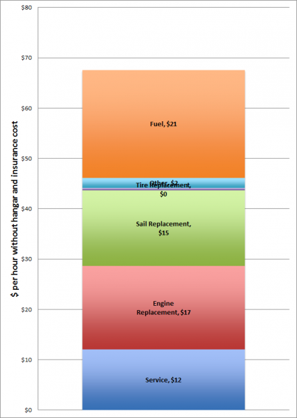

kasper Posted May 11, 2016 Posted May 11, 2016 Useful spreadsheet - and using it this is the 'cost' of a simple 2 stroke (447) replaced at 300hrs on a flexwing trike with a main airframe cost of new sails at around 500hrs ... this is the hourly cost over life if you use an L2 for the work and do not make/do things yourself. I can do better than that as I (like many) run a rotax 2 stroke through 2-3 lives before retiring them and the 300hr rebuild is around 2/3 of a short engine (if you can get one) and the sail on the trike IF I make it myself (have own sailloft) is around 1/3rd the cost in materials and of course my maintenance costs are about 1/2 that as its just parts But you can see that even if you do just about everything yourself its still around $50/hr in cash to keep a little simple plane flying. And with my trike costing me under $3,000 to build complete (I scrounged, used second hand and reused anything from the scrap bins at the factories I was hanging out in that was not nailed down) it will still costs me more to run every 100hrs than it did to build.
