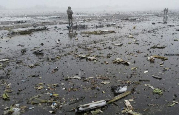

Bats Posted March 19, 2016 Posted March 19, 2016 Correct - it was a quick n dirty look at the trace and a reaction to the suggestion that they were burning off fuel. Hanging around for that long between approaches indicates a fair degree of determination to get in, especially when others in the area pushed off to alternates. Avherald are quoting officials as saying aircraft clipped the ground during a second go-around and then dropped back to the ground near the upwind end of the runway. Some translation confusion as to whether it was a wing or the tail that struck the ground. From the photos and video doing the rounds it looks as though the aircraft was pretty much reduced to kit form, with small pieces scattered over a large area.

fly_tornado Posted March 19, 2016 Author Posted March 19, 2016 pictures out of russia are very sad, 1

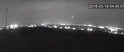

Bats Posted March 19, 2016 Posted March 19, 2016 As usual the elderly plum has a mix of insightful comment and utter BS. I see the earlier version of "the aircraft struck the runway on go around and lost control" has now been discounted and the CCTV video reinstated as credible (all part and parcel of the confusion following accidents I guess) - the go around appears to have been initiated well above runway height, as was the first one and the aircraft climbed and accelerated more or less as you would expect, before nosing over at a steep angle and diving into the ground near the threshold. The one other comment that struck me, was that alternates out in the wilds of Russia are not as you would expect in Europe/US etc - you could easily end up stuck in a cold plane with no ground support and a plane full of unhappy pax. Thus a 2 hour hold would be considered preferable to the alternates.
jetjr Posted March 20, 2016 Posted March 20, 2016 Latest cctv on news seems to indicate fire before accident
Birdseye Posted March 20, 2016 Posted March 20, 2016 Quote Latest cctv on news seems to indicate fire before accident I'd suggest that it was the final impact following a catastrophic bounce, but time will tell. Some media idiots have posted "black box" recordings which are actually short exchanges with ATC, but if real they show that the crosswind had dropped off significantly.

fly_tornado Posted March 22, 2016 Author Posted March 22, 2016 I don't know but almost looks like its on fire before it hits the ground https://www.youtube.com/watch?v=-AlAjy7hg_Y
fly_tornado Posted March 22, 2016 Author Posted March 22, 2016 too bad it showed a better angle, it was a fast, very steep nose down impact
Bats Posted March 22, 2016 Posted March 22, 2016 Ah, probably the one I saw from an overseas site earlier. Slowed playback down and in the last frame or two you could see aircraft quite clearly, 60 deg nose down at a guess and rolled well over as well. Didn't look anything like the graphics I've seen of AF447 coming down wings level and belly first. Edit: Yes that looks like a frame from the video I saw.
