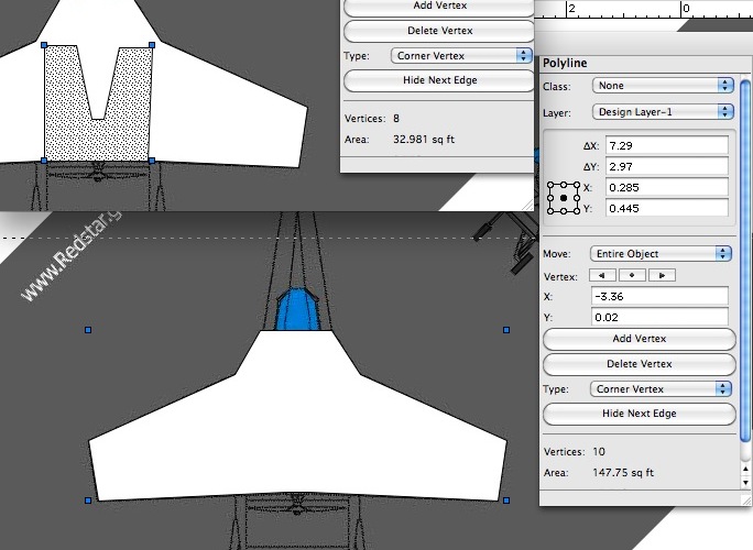

pylon500 Posted March 24, 2016 Posted March 24, 2016 Just fed the drawing into my CAD program, remember the top of the fuselage on this is also part of the main wing, which appears to have around 147.7 sq ft (13.7sqm) of area, which is way over the maximum required 10 sq m for 95:10, and if you add the lower wing which is another 32.9 sq ft (3.0sqm), this is easily a 95:10 aircraft. 1
winsor68 Posted March 25, 2016 Posted March 25, 2016 And the wing loading ofSF-1 Archon Aerosports gr" IS? VH experimental spacesailor It is one big wing. It would have to have a very low wing loading.
