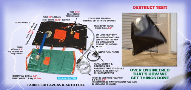

walrus Posted September 17, 2020 Posted September 17, 2020 You should have an earthing clip on your hose and an earthing point next to the fuel cap. The hose should be fuel hose which is conducting, not plastic. Mr. Funnel makes a conductive plastic funnel. A purpose made electric fuel pump (eg Holley) SHOULD be intrinsically safe. Most dangerous time is a still, cold winter morning. We blew the back wall out of a service station once. The tank vent was just above the roofline. The space in the double brick wall filled with fumes. The owner went to make a coffee for the tanker driver. The wall disappeared when he switched on the electric jug! 1
skippydiesel Posted September 17, 2020 Posted September 17, 2020 You can utilise an electric automotive fuel pump, but the connections you install are the critical area. A properly-designed petrol pump is totally flameproof. Arcing at connection points is a real threat. No "consumer level" electric pump is designed for pumping petrol, they all specify "diesel only". The danger is in the fumes, not the liquid. Remember, petrol fumes in confined spaces have substantial explosive power - and even in unconfined spaces, they will start a fire from many metres away. After you've watched a 200 litre drum, containing nothing but petrol vapour, travel 300M after it's been ignited (purposely, for demonstration purposes), you gain a whole new level of respect for the power in petrol fumes. Sorry - Not true! I use a Holly type "vain" positive displacement petrol transfer pump - have had no problems over the last 5 years or so. You will find this discussion/photos etc elsewhere on this Forum
skippydiesel Posted September 17, 2020 Posted September 17, 2020 Hi One track .yes all correct ! you wont find me using an electric pump with wires dangling out of it near gasoline, unless the cable is double sheathed in stainless braid, the connection double strain relieved and fuel proof flex plastic over-molded into a pump with a failsafe internal barrier between the motor and the liquid housing. I agree there are safe pumps, but the hand pump us OK for me only 60-150 litres... . I'm not pumping 500 litres in. The certified intrinsically safe explosive atmosphere gasoline pumps with all their suitable wiring and connections all foolproof is not cheap. Call me risk averse, but fueling an aircraft with gasoline is a hazardous activity IMO, and hence I will do it in a suitable risk mitigated manner. I bow to your academic knowledge - however with care & attention to detail ( remote switch, sealed pump, static line and well vented area) the risk is negligible. See my comment above.
jackc Posted September 17, 2020 Posted September 17, 2020 Sorry - Not true! I use a Holly type "vain" positive displacement petrol transfer pump - have had no problems over the last 5 years or so. You will find this discussion/photos etc elsewhere on this Forum Turtlepac use a Holley pump for fuel transfer from their bladders.
onetrack Posted September 17, 2020 Posted September 17, 2020 Skippy, you may have been using a Holley vane-type fuel delivery pump successfully for 5 years - but all I'm saying is, that your connections to the Holley pump are not explosion-proof, not certified for pumping petrol, don't meet any Australian Standard for petrol-pumping equipment - and you may find yourself in trouble if you start a fire, and damage results. Your insurance may not cover you. IMO, the simplest and most foolproof method of fuel transfer involves a little air pressure. You only need 2-3psi to transfer fuel, and all fuel containers will handle considerably more pressure than that figure. https://www.aircraftspruce.com/catalog/pspages/goatthroat.php 1
RFguy Posted September 17, 2020 Posted September 17, 2020 I'm a big fan of air driven pumps. but I mainly see then on irrigation- pumping water up from a river. the 1/4" air line runs down the middle of the poly pipe to the pump . sounds like a frog croaking. great link onetrack Glen.
onetrack Posted September 17, 2020 Posted September 17, 2020 (edited) The site below is a helicopter website, but it's a pretty useful page to keep potential refuelling problems uppermost in your mind. Note that the story of the helicopter pilot getting burnt by a fuel explosion says, "as the alligator clips came off the battery terminals, they touched, and caused electrical arcing". The alligator clips did not even have to touch anything, as soon a connector carrying power is (accidentally) disconnected, you have an arc. I have a friend who was burnt badly simply by opening the flip top of a steel jerrycan, whilst securing it between his legs. The jerrycan had been warmed by the sun, and the petrol expansion made the higher level of petrol in the can gush out, over his legs and feet. There was a campfire burning some 8 to 10 metres away, the fumes drifted straight to the fire and ignited, and the flames travelled back to the jerrycan, and set him alight within a few seconds. http://brumbyhelicopters.com.au/refuelinginfield.htm Edited September 17, 2020 by onetrack
skippydiesel Posted September 17, 2020 Posted September 17, 2020 Skippy, you may have been using a Holley vane-type fuel delivery pump successfully for 5 years - but all I'm saying is, that your connections to the Holley pump are not explosion-proof, not certified for pumping petrol, don't meet any Australian Standard for petrol-pumping equipment - and you may find yourself in trouble if you start a fire, and damage results. Your insurance may not cover you. IMO, the simplest and most foolproof method of fuel transfer involves a little air pressure. You only need 2-3psi to transfer fuel, and all fuel containers will handle considerably more pressure than that figure. https://www.aircraftspruce.com/catalog/pspages/goatthroat.php No offence taken - all advice welcome- I have gone to considerable trouble to spark "arrest" my system - all electrical joints are double shrink taped. My switch is similarly "coated" and on the end of a long lead. My power supply is via long lead and Anderson plug in cockpit - connection is made befor opening tank, fuel can and only disconnected after all closed. I have a earth connection to ground and the engine - aircraft is compost, as is tank, so no ground there. I only fuel up with hanger doors open, keep fill spout down in funnel (low Oxygen) and suction spear almost fills the neck of fuel can. This fuel transfers system is fully portable and goes away with me on long trips, for decanting 20 L fuel bladders. Yes there is still a risk but then leaving the ground is a risk, as is driving, riding horses,, alcoholic beverages and smoking substances, etc etc Its all about management & acceptable levels - life is risky and I wouldn't want it any other way

skippydiesel Posted September 17, 2020 Posted September 17, 2020 No offence taken - all advice welcome- I have gone to considerable trouble to spark "arrest" my system - all electrical joints are double shrink taped. ............................................................................................................................................................................................ Yes there is still a risk but then leaving the ground is a risk, as is driving, riding horses,, alcoholic beverages and smoking substances, etc etc Its all about management & acceptable levels - life is risky and I wouldn't want it any other way I knew I had missed something: My quest to find a less physical way of fuelling my aircraft. In my mind, I have not aged but the mirror and my inability to hold 20 L of fuel at chest hight for more than a few minutes, tell a different story. You talk of "risk" - well what risks are involved with a less than youthful old git trying to put fuel into his aircraft using a 20 L drum held at chest hight? I can tell you. Its all good as I hoist the 20 L up -Ssloooowly tip the opening/nozzle toward the funnel. Splosh splosh, gurgle gurgle... DAMN! I am starting to shake. SH........T its splashing over the side of the funnel. Every expletive I know - I have a fuel drenched leg - it stings it stinks and I dont have a thought about fire. Put the damn drum down -, take a brake, try again. There is a better way and it may have risks but probably less than having carcinogenic hydrocarbons repeatedly splashed on large areas of aged skin, never mind the discomfort of the the smell or the stinging . 1 1
