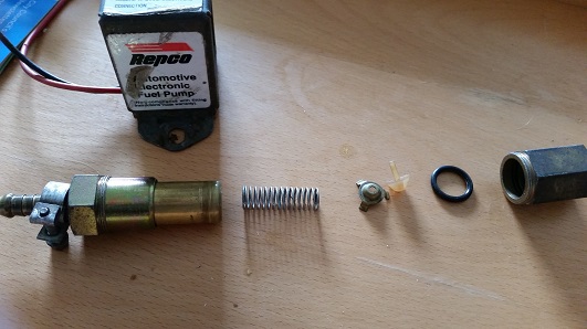

spacesailor Posted April 17, 2016 Posted April 17, 2016 Has anyone got an 'internals' picture of the "Repco" fuel-pump, So I can reassemble after I strip & clean it. spacesailor 1
Ayecapt Posted April 24, 2016 Posted April 24, 2016 Video ......video everything as you pull it apart In the my dim dark past i repaired Vcrs ...mech nightmares in the early days but a video camera was the greatest memory tool.
spacesailor Posted April 30, 2016 Posted April 30, 2016 Ayecapt I have only used a camera: but I suppose has the same results. If any one requires a quick reference for the "Repco" there are two valves, the outlet I didn't remove. spacesailor
