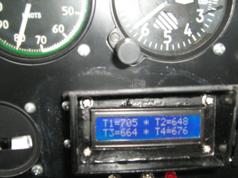

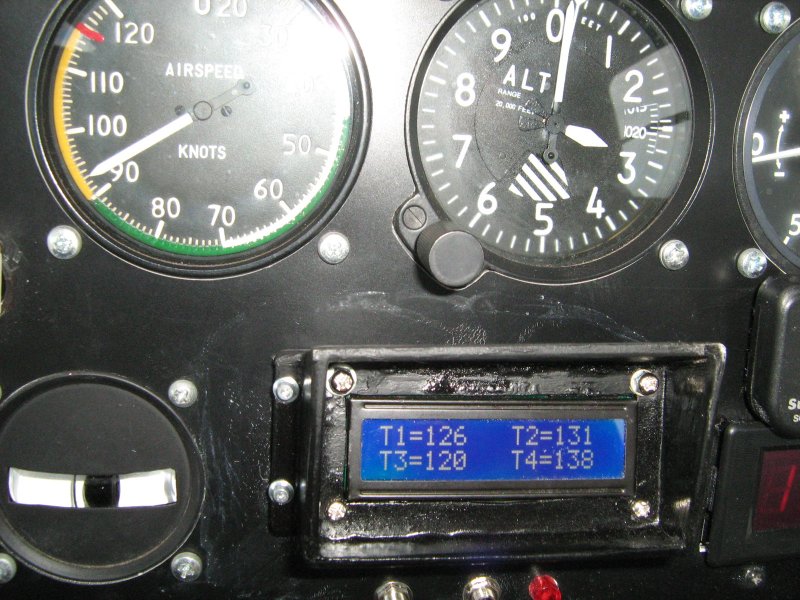

Bruce Tuncks Posted August 5, 2016 Author Posted August 5, 2016 Here's the latest pics. The second is EGT on cruise-climb at 80 knots and the first is CHT on cruise at 90 knots . I reckon the problem is solved, as the no 4 is no longer the hottest one and they are more even than before. The best mod was the cross-vane in front of the distribution box. Thanks everybody and especially Jab 7252 who designed the electronics and software. 2 1 1

Bruce Tuncks Posted August 5, 2016 Author Posted August 5, 2016 Yes, Jaba-who, the vane consists of 2mm brass tube filled with steel wire, in a cross and sunk into the rubber fitting which holds the carby. At the NS and EW positions I hollowed out the rubber fitting a bit where it joins the distribution box so the cross-vane is clamped between the rubber fitting and the distribution box, but fitted in so as not to let air leak in there. Then I soldered 3 tinplate vanes, wrapped around the tube and extending about 12mm to the rear and curved so as to deflect the stream into no4 cylinder and no3 cylinder and away from no2. It was jetjr who said that vanes downstream of the carby were more effective than upstream and this turned out to be the information I needed. I have not seen the factory setup but I assume they have done something similar. Nothing I did upstream seemed to have any effect ( remember the straws in the pipe) and even the extended pipe "catcher" from no4 pipe into the distribution box didn't change the temperatures much, so these things have been discarded and only this vane remains.
Bruce Robbins Posted August 5, 2016 Posted August 5, 2016 What the standard vane?Interested in how you made it so you could rotate Hi Jetjr, The vane is a modified version of the cobra head fitting that attaches the scat hose to the carby mouth on a standard Jab install. They have fitted intersecting plates that run the length of the cobra head, effectively dividing the tube into 4 sections. Normally you would install the cobra head so that the outlet sits nicely in line with the outlet from the air box, keeping the scat hose run nice and straight.Because it clamps to the carby mouth you can rotate it a little either direction. jabiru cobra head - Google Search 1
Bruce Tuncks Posted August 6, 2016 Author Posted August 6, 2016 Sorry, I didn't really answer jaba-who about what I meant by the distribution box. Here is the bit I mean, some call it a plenum chamber. The vane is between the rubber fitting and the cast metal part, which is part of the sump on my early model engine. You will also notice how the hose-clamp is too far from the carby rubber end. The carby can actually fall out with it like that... I hope I didn't fly with it. The hose clamp should be flush with the end of the rubber.
