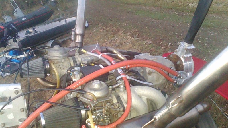

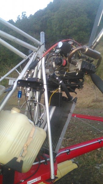

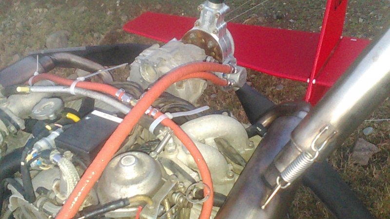

Byron Posted April 9, 2016 Author Posted April 9, 2016 Quote Possible that the distribution spider eg the splitter to the carbies and return line has been incorrectly fitted. The return line /pressure gauge fitting has a restrictor in the fitting. If installed in a carby supply line one carb is starved of fuel. An easy error to make if not knownMick W I double tripple checked the fuel line assembly mick, looks all correct. This system doesn't have a return line. Here are some pics

Blueadventures Posted April 9, 2016 Posted April 9, 2016 Quote [ATTACH=full]42403[/ATTACH] [ATTACH=full]42404[/ATTACH] [ATTACH=full]42405[/ATTACH]I double tripple checked the fuel line assembly mick, looks all correct. This system doesn't have a return line. Here are some pics Hi Byron It looks like your carby overflow hoses are longer than usual / specified. Is that the length you have been flying with? I'm no expert so my comment is only that you should check with rotax manuals or a rotax service tech. Are you also checking on the Rotax Owner forum threads? Cheers Mike

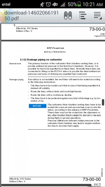

Byron Posted April 9, 2016 Author Posted April 9, 2016 Can you send me a link to the required length of the carb float vent line. I just looked through the installation manual and it just discussed diameter of tubing and avoid placing the end of the tube in a slip stream. Requirements on the drainage piping: NOTICE With closed or blocked leakage piping, fuel could end ƽWARNUNG up on exhaust system. RISK OF FIRE! - The lines have to be routed such that in case of damage the surplus fuel is drained off suitably. - Route the lines without kinks and avoid tight bends. - Route the lines with a continuous decline. - The lines have to be protected against any kind of blockage e.g. by for- mation of ice. venting lines Float chamber venting lines (1): Float chamber Connecting nip- ple for leakage line NOTICE The float chamber venting lines (1) have to be routed into a ram-air and vacuum free zone or into the airbox, according to the requirements and release of BRP-Powertrain. See chapter “air intake system“. These lines must not be routed into the slipstream or down the firewall. Pressure differences between intake pressure and pressure in the carburetor chambers may lead to engine malfunction due to incorrect fuel supply. Connecting nipple (3) for leakage line: -Outside dia. 6 mm (1/4‘‘‘) -Slip on length Max. 17 mm (11/16‘‘)
Byron Posted April 9, 2016 Author Posted April 9, 2016 Screenshot of the installation manual regarding routing the carb vent line
