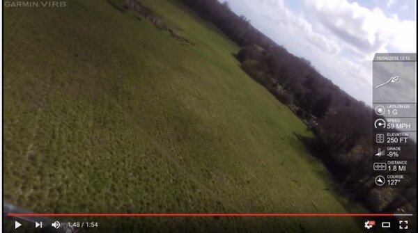

I am sure he could have made a slower approach & had a far lower ROD if he had wanted to, however Kev was hyped up having just seized the engine & from what I read elsewhere he knows himself that he didn't get the best options in his choice, but saying that I would have probably made 80% of the same decisions in the same situation ( I would have stayed away from the tree on the last turn before touchdown & not momentarily aimed at the Manor House ) All very easy to say after the incident though.

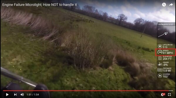

Hiya Ian,. . . I looked at the video arround 9 times,. . and at the final impact point the indicated speed on the right hand panel was between 56 and 57,. . . this altered from 47 earlier, so it is possible that he landed with a bit of a tailwind component, but as we all know ( well, those of us who have experienced multiple engine failures in silly non-certified aerial appliances anyway ) that things can become exciting if there is not much height to play with when it goes quiet, and if you feel that the landing options are a little none friendly.
These are high stress moments; few pilots can say with honesty that they would have done this, or that . . . as you point out and we already know, armchair hindsight. . .etc. . . . Me ?.. . .well, following a dead ignition coil in my Gemini Flash 2, I've landed in a bloody tight field, with my non-pilot passenger constantly tapping on my left arm, and me waving my hand in dismissal, thinking, . .Not now sweeetheart, I'm a bit busy. . . . ( intercom failure ) when the passenger was trying to tell me that she had seen an orange windsock in a field not 1/4 mile to my left, behind a small stand of trees. . . . . Tunnel vision ?
Yes,. . . 56 / 57 MPH is quite a velocity when you come to a sudden stop, much decelleration force. Lucky lad. Sounds as if you actually KNOW the daft bugger,. . . I only chat to him on numerous forums, BMAA, . . . Microlight Flying, . . Fizzogbook . . . etc. . . Lovely bloke, being the owner of a very incisive engineering mind. . . .
In any event, I hope that the trike had some hull insurance. . . he's back on FB now, posting stuff about magic magnetic engines and diggers getting stuck in the mud etc. . . .

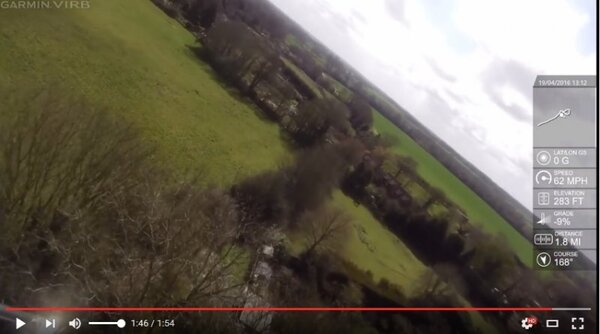

From the look of how the cloud shadows were moving, did he land with a bit of a tail wind? As said before, there were a whole lot of other options, but we can only say that in hindsight. I don't know if I'd do any better when the adrenaline starts pumping. I remember in my emergency training selecting what looked like a very smooth field to land in from 2000ft, only to find at about 500ft that it was a bit rough, but I was committed. You can't go changing your mind when you have no altitude, so you have to see it through. I'm glad he is ok.The video is priceless, watching it got me thinking of my emergency training.
I agree the video is great sharing.
I see there are two power lines showing the direction of the wires (pause the video near its end) that would account for the veer to left at the end to avoid the power lines that ended up bowling over the low scrub.
The comments re airspeed in other threads should alow fr the lag in the AIS indicated reading.
Certinaly an acceptable outcome.
Cheers

and at the final impact point the indicated speed on the right hand panel was between 56 and 57,. . . this altered from 47 earlier, so it is possible that he landed with a bit of a tailwind component,Phil
Hey Phil he might have landed with a tail wind but that does not affect the indicated airspeed just the ground speed. It is easy to criticize but he walked away and some pea-brains call that a good landing.

The Speed is GPS related so I think the lag is a millisecond....much the same as 12g was a millisecond....... I must look at the video again to see the cables.... now starting to think Kev was giving a lot more thought to this than just plonking it down wherever it happened.

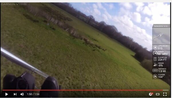

And I am not criticizing anything.
That comment was not aimed at you but others who said there were so many better options. My guess is some of the people who reckon it could have been done better are probably right but when was the last time they did it better?

The simple answer is : " Yes, He did it right "
Maybe I am over-analyzing this from the comfort of a relaxed position on a soft sofa, (which is something Kev didn't have during that flight) so I am convinced "he did it right"
In the video @ 1m45 he is at 302ft QNH having descended from 378ft QNH @1m40 to 329ft QNH @ 1m43. A turn around the tree @ 1m46 at 283ft QNH to establish himself on final approach to his impending arrival spot looked (from the comfort of a sofa looked to be extremely close to the branches ) @ 1m48 at 250ft QNH he was fully established on final & committed to what was about to unravel...... 2seconds later @1m50 he was 224ft QNH & possibly sensing " I am nearly there !!! @ 1m51 the impact with the bushels was imminent and at this point with 61mph of groundspeed I think ( from the comfort of a sofa ) I would have converted a bit of speed for a bit of height to clear the bushels ( Note it is an opinion based on hindsight & not what I might have done if in Kev's position at that time, at that exact time I strongly believe I would have done exactly what Kev did. )
The interesting point is throughout the entire final section of the video a 9% descent profile was set up ( which looks to resemble a 948fpm descent rate or 15.8fps )
