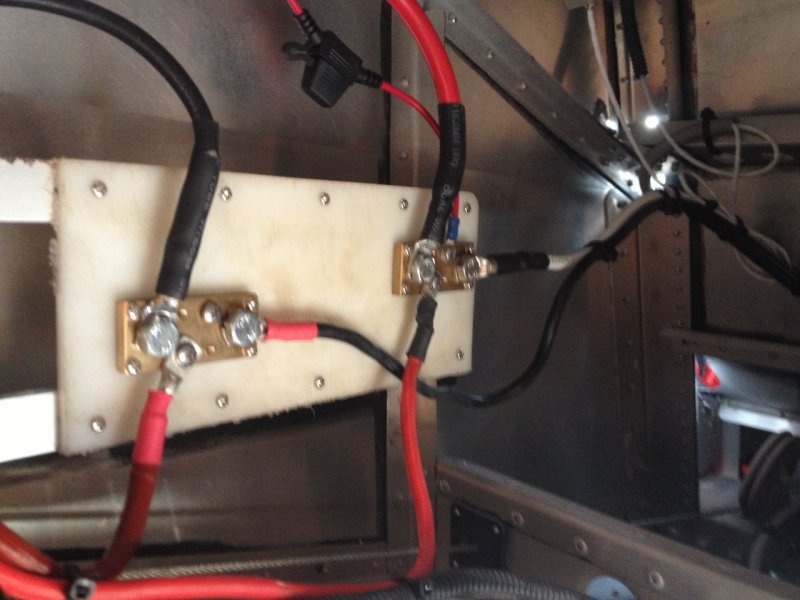

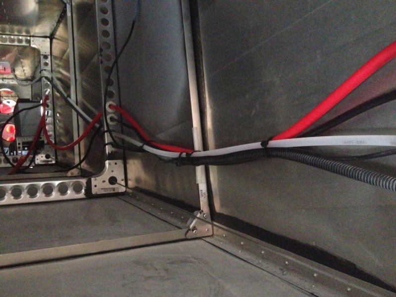

Kyle Communications Posted May 17, 2016 Posted May 17, 2016 Quote Thanks for the pics and the different solutions to the problem! Kyle, how is your box installed? It looks like the stock battery box but I can't see how you've modified it... Thanks all! I originally had the battery box installed behind the pilot in the aircraft as per the manual I have, but was a bit nose heavy when I got her flying. I removed that box and installed it in the rear position which then balanced the aircraft beautifully. It is mounted where the manual says but that is why I have installed the second door on the other side of the aircraft. It gives me lots of room for a tool kit in the rear as well. I can easily put about 6kg into the rear without being detrimental to my W&B

mcrowley Posted May 18, 2016 Posted May 18, 2016 Quote I originally had the battery box installed behind the pilot in the aircraft as per the manual I have, but was a bit nose heavy when I got her flying. I removed that box and installed it in the rear position which then balanced the aircraft beautifully. It is mounted where the manual says but that is why I have installed the second door on the other side of the aircraft. It gives me lots of room for a tool kit in the rear as well. I can easily put about 6kg into the rear without being detrimental to my W&B Kyle... Do you have any drawing, pics, or closeups of the install? I'll need to do the same but I'm still trying to "engineer" the install... Thanks!!!

Kyle Communications Posted May 19, 2016 Posted May 19, 2016 Quote Kyle... Do you have any drawing, pics, or closeups of the install? I'll need to do the same but I'm still trying to "engineer" the install... Thanks!!! The sheets in the kit had the holes punched for the battery box to go into either location. The manual I had in the kit said to install the battery behind the pilot. As I said I wasnt happy with the balance when flying so decided to move the 8kg down the back to where the battery was in the savannahs overseas. The factory ones here come with the battery behind the pilot from what I have seen. I then used quite thick gauge cables to run from the rear to the front for starting. I basically made a junction box where the battery was using a nylon plate with tapped brass junctions so everything could be well bolted and insulated. This also gave me a easy connection point for my battery charging terminal access as all of this is before my battery isolation switch. I have some pics I hope they show you what I did and give you some ideas. This was all done some 5 months after I got the aircraft flying. But it was easy as the holes were already in both positions.
