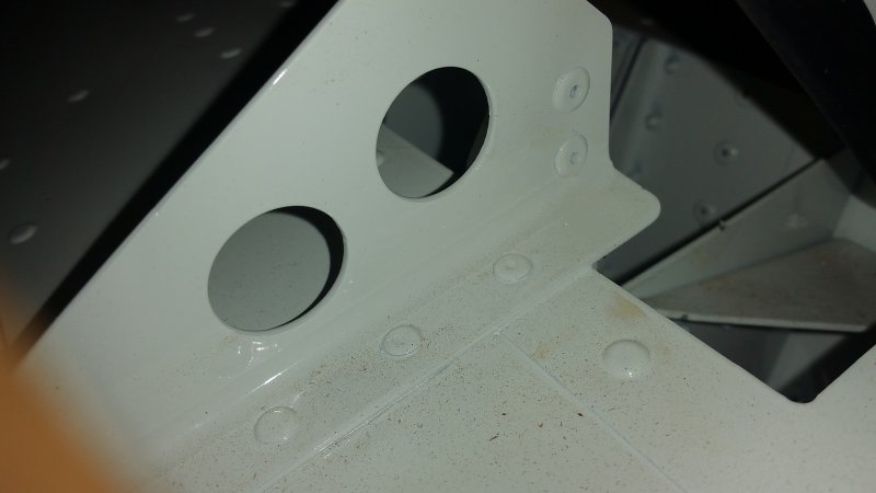

rankamateur Posted June 1, 2016 Posted June 1, 2016 Barely visible once assembled, look just in front of the elevator control horn (rivets without heads). Quote one of the other builders on here has done. I think that will be okay, and from the various pics I have been able to find, I doubt they will be visible (?)
IBob Posted June 1, 2016 Author Posted June 1, 2016 Quote Barely visible once assembled, look just in front of the elevator control horn (rivets without heads).[ATTACH=full]43377[/ATTACH] Thanks for the detail, Steve. Yep, I'm happy with that. And the overriding object here is to have the stabiliser attached firmly to the rest of the aircraft!
