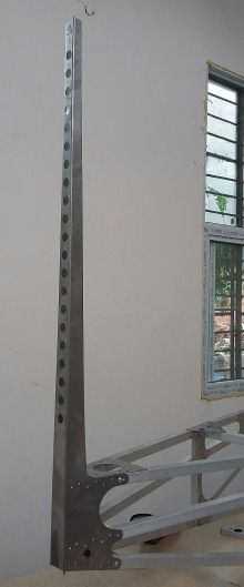

bexrbetter Posted July 21, 2016 Author Posted July 21, 2016 So with my hand a bit crook and the stinking humid hot weather we have had for a week (normal this time of year, not GW!), updates have been sparse because I have been doing a lot od CAD work instead at home. I did manage to get a tail post done though, this is a test one, not the final but similar ... 7

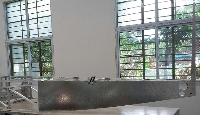

bexrbetter Posted July 23, 2016 Author Posted July 23, 2016 The main reason that I haven't done any sheeting on the frame yet is because nothing is set in stone and I am concerned about knocking the panels around during development and needing to replace them. However a few items to do with the tailfeathers requires that the sheets are designed in as well so today I drew up a test sheet and cut it from some cheap steel sheet just to check fitment before I commit to an aluminium sheet that I don't want to waste, happy that it fitted perfectly first time ... Oh and an aluminium sheet is usually 1220 x 2440, cheap gal steel sheets are 1000 x 2000 hence the gap at the rear you see. 2
onetrack Posted July 23, 2016 Posted July 23, 2016 Bex, that tail post looks a little flimsy to my untrained eye. Seems like it needs more metal depth, front-to-rear. Remember the Lovebird crash (VH-UGF)? That was caused by useless Oregon timber. The rudder post collapsed, and the result wasn't nice. My recommendation is to steer clear of any Oregon in the build. Well, maybe you could have Oregon trim around the instrument panel. 'PLANE CRASH. - Grave Statement at Inquiry. BROKEN RUDDER POST. TEMORA, Tuesday. - The Sydney Morning Herald (NSW : 1842 - 1954) - 29 Jul 1931
bexrbetter Posted July 23, 2016 Author Posted July 23, 2016 Bex, that tail post looks a little flimsy to my untrained eye. Seems like it needs more metal depth, front-to-rear. I am very wary in these critical areas and happy to add a bit of weight, it is well over requirement and probably double the weight it could be. Please bear in mind that it is also part of an integrated, complete structure and can't be judged on it's own. 1 1
AussieB1rd Posted July 23, 2016 Posted July 23, 2016 and cut it from some cheap steel sheet just to check fitment And not a Cleco in sight
bexrbetter Posted July 23, 2016 Author Posted July 23, 2016 And not a Cleco in sight No holes in the frame at all, only in the test sheet. Was a perimeter fitment check and vertical brace hole alignment check. A couple of riveted tabs to the sheet bent over the top frame tube and a G'clamp. I then used a black texta to mark the frame through the holes in the sheet to see where they lay. Not rocket science.
