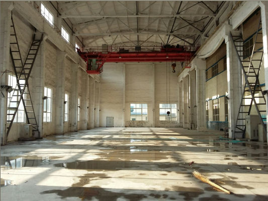

Large factory for free for a few years courtesy of the Local government.
It doesn't leak, have been cleaning it out for a few days. Note the broom, group of branches tied together, they grow them for the purpose, they work surprisingly well.

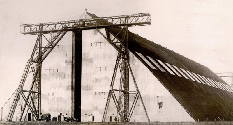

I trust the new shed resembles this, in dimensions? .... 003_cheezy_grin.gif.c5a94fc2937f61b556d8146a1bc97ef8.gif
You don't want to run yourself short on working area - and you just know, that every shed you end up in, is always just a whisker too small .... 006_laugh.gif.0f7b82c13a0ec29502c5fb56c616f069.gif
Yes I know what you meant, I was been intentionally obtuse 003_cheezy_grin.gif.c5a94fc2937f61b556d8146a1bc97ef8.gifLarge factory for free for a few years courtesy of the Local government.
[ATTACH=full]44930[/ATTACH]
[ATTACH=full]44929[/ATTACH]
Those X-shaped ladders are an interesting design. When you get to the junction do you squeeze through the rung to keep going, or do you go up the outside hanging by your hands?
:drool:Complete with overhead travelling crane??? 012_thumb_up.gif.cb3bc51429685855e5e23c55d661406e.gif
O.K. Just let us know, what the compensation agreements are, that are part of getting this deal?? 028_whisper.gif.c42ab2fd36dd10ba7a7ea829182acdc1.gif034_puzzled.gif.ea6a44583f14fcd2dd8b8f63a724e3de.gif

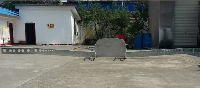

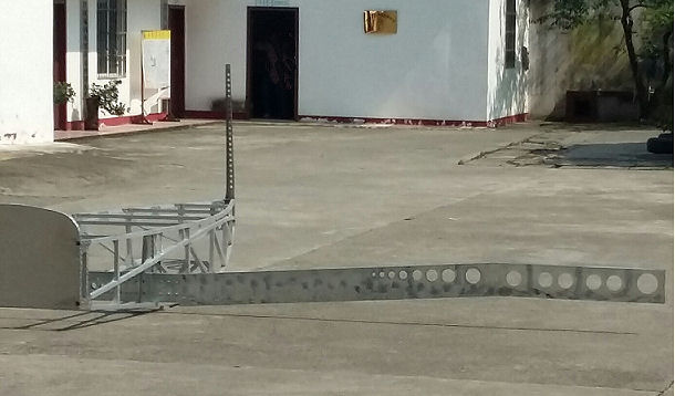

I tried to take some pictures today of the proto trial fitment but the sun was so darn bright I couldn't see the phone's screen properly so you get what you get ...

How many joins in that wing section, Bex? How are the joins made? Doesn't every added join weaken the member? Isn't it better to have one complete, untouched member for the section, for strength?
Most importantly, we can't see how the flapping mechanism actually operates. 003_cheezy_grin.gif.c5a94fc2937f61b556d8146a1bc97ef8.gif
  • Haha 1
I guess the 'gull wing' gives you that bit of being different, but a structure still needs to be 'arranged' correctly.
To that end, the inner lightening holes are in the wrong place.
Usually they would run along the centreline of the beam, as that is the neutral point along the shear plane.
Technically, as sheet structures will resist tensile loads better than compressive loads, the lightening holes would more correctly taper down towards the lower cap, keeping more material in the compressive area of the shear web.
Just saying...
