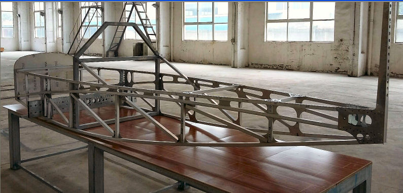

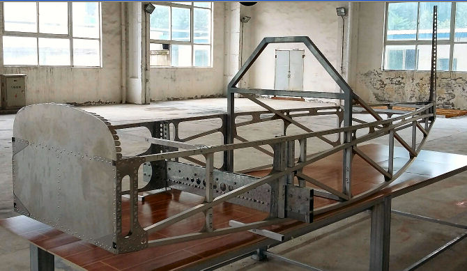

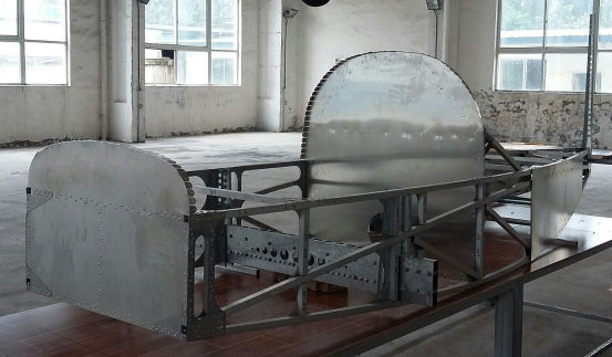

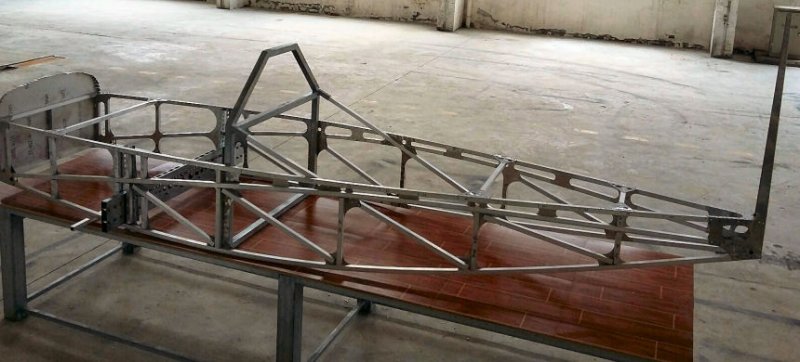

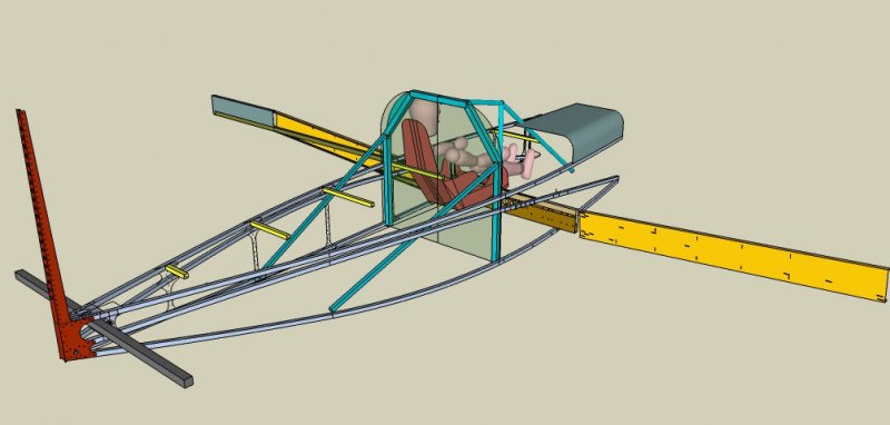

bexrbetter Posted August 31, 2016 Author Posted August 31, 2016 Well now that the repressive heat seems to have settled down (was 23 degrees in the factory yesterday, was 46(!) last Friday), I am getting back up to speed. Trying out a few roll bar ideas and the integration of them into the frame, obviously wanting strength and safety without compromising on weight too much .. ,, and those with a keen eye for fashion will notice the new sexy colour scheme for the build table tiles. 3
onetrack Posted August 31, 2016 Posted August 31, 2016 Are you planning to have cut and welded bends in the roll bar final design, or will the final product have superior pressed bends? The latter would look better and be cheaper to produce, I would imagine. I'm personally not sure that the bar from the centre of the roll bar to the footwell area is all that necessary. What are you planning for the canopy, a simple bubble design? Looks good, otherwise.

bexrbetter Posted August 31, 2016 Author Posted August 31, 2016 cut and welded or bent roll bar design, It's not important at this moment, the size, shape parameters and integration are what's being achieved first. I'm personally not sure that the bar from the centre of the roll bar to the footwell area is all that necessary. Try telling that to somebody upside down smelling petrol ...... I intend to have one of the safer aircraft out there. Make it darn easy to get in and out of too, people do hurt themselves just doing that. What are you planning for the canopy .. That depends on how the ROPS works out. 1 1

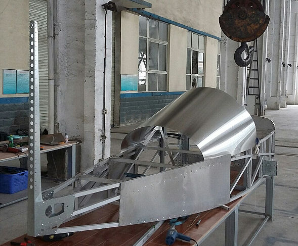

bexrbetter Posted September 7, 2016 Author Posted September 7, 2016 Just been mapping out some bodywork and other unseen stuff. The turtledeck is a bit low at the rear from unsupported sagging. 7
badwookie Posted September 8, 2016 Posted September 8, 2016 Bex, I hope the turtle deck wasn't that heavy that you had to use the crane to fit it! 2

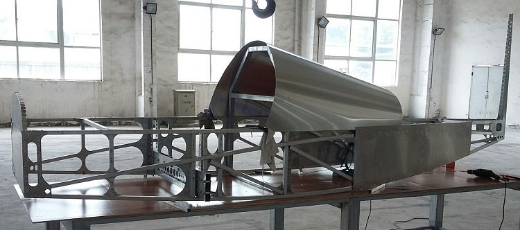

bexrbetter Posted September 8, 2016 Author Posted September 8, 2016 .. and I drew up a rear bulkhead last night to support the front of the turtledeck, cut and trial fitted it today .. 5
