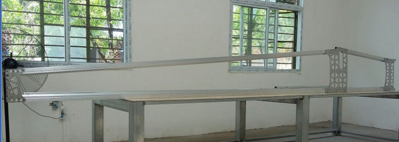

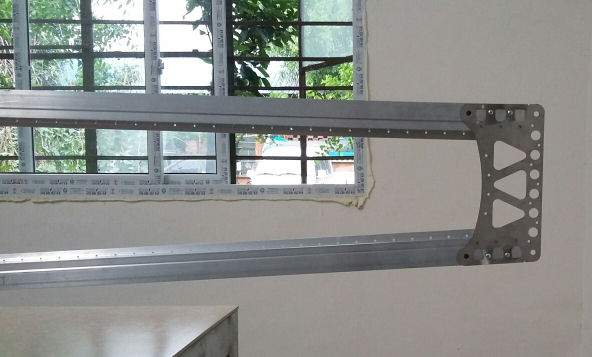

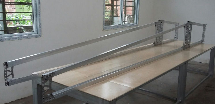

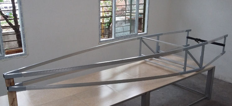

bexrbetter Posted May 22, 2016 Author Share Posted May 22, 2016 Ahhh, so we are on to Plan B, or is it Plan C or D? I'm a little puzzled here. You speak of "I am not happy with the continuity of supply for material, and especially welding to my standards" ... I was under the impression that Plan A involved inserting sections into stamped cut-outs in lengths of extrusion. I didn't see any welding involved in that design. Did I miss something? Yes you missed the grey coloured, welded box sections at the nose, middle and tail holding it together. They are what I am not happy with to supply reliably to a standard. The side plates are riveted and bolted on and can be simply cut from which ever material I choose such as Chrome Moly, a 7000 series Al or Titanium sheet Have a look again at this picture then reference the "rubbish pile" picture just above ... 1 1 Link to comment Share on other sites More sharing options...

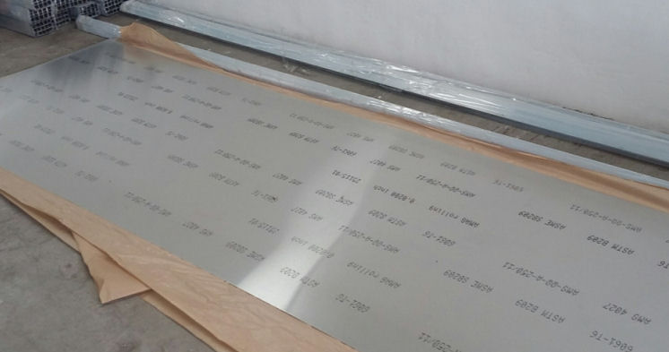

bexrbetter Posted May 22, 2016 Author Share Posted May 22, 2016 Oh and my sheets finally arrived .. 2 Link to comment Share on other sites More sharing options...

onetrack Posted May 22, 2016 Share Posted May 22, 2016 Ahh, I see now what I missed, thanks for pointing that out. You do realise, of course? - that by the time you have mastered 2D or even 3D CAD, and settled on a superb, labour-saving, totally new, and cunning design - that a 3D-printed aircraft frame will promptly make your idea look like a Model T Ford?? Beijing University Unveils Enormous 3D Printed Aircraft Frames & More, Created with SLS Technology Link to comment Share on other sites More sharing options...
bexrbetter Posted May 22, 2016 Author Share Posted May 22, 2016 that a 3D-printed aircraft frame will promptly make your idea look like a Model T Ford?? Yeah, but mine will still be the price of a Model T Ford. I can get some similar just around the corner in Ti, albeit machined, not printed. Got a picture somewhere I think, will look tumurru. 1 2 Link to comment Share on other sites More sharing options...
Downunder Posted May 22, 2016 Share Posted May 22, 2016 I like the flat plates over the welded frames because they are easier and cheaper to make. The packing at some point needs to be looked at and the plates "flat packed" will ultimately result in a smaller overall package. They are less likely to be damaged in transit too. It all needs to be considered...... Link to comment Share on other sites More sharing options...
bexrbetter Posted May 23, 2016 Author Share Posted May 23, 2016 I like the flat plates over the welded frames because they are easier and cheaper to make. ... and a valid point is the laser will cut any material to the pattern, except carbon fibre which can be water cut. But I have a laser 5 minutes away so aluminium, chrome moly, titanium or stainless is the choice. Most likely Ti or stainless as they are at arm's length and available by the sheet. 440 stainless is stronger than chrome moly btw. 1 Link to comment Share on other sites More sharing options...

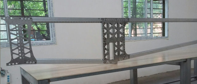

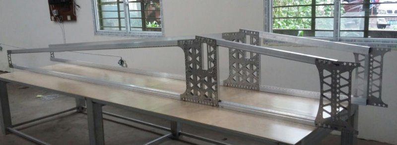

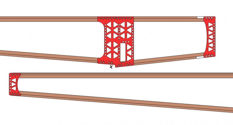

bexrbetter Posted May 23, 2016 Author Share Posted May 23, 2016 So after another late night of designing nose and tail modules and today turning them into CNC files and sending them to my laser guy, hopefully tomorrow I will have some bits that look like this in real life ... In case anyone is wondering about the step in the frame where the 'X' is, that's where the landing gear goes. Link to comment Share on other sites More sharing options...
pylon500 Posted May 23, 2016 Share Posted May 23, 2016 In case anyone is wondering about the step in the frame where the 'X' is, that's where the landing gear goes. So no option as a taildragger? If you came up with a way of making the plate symmetrical, you could just reverse it for tail wheel set up. 1 Link to comment Share on other sites More sharing options...

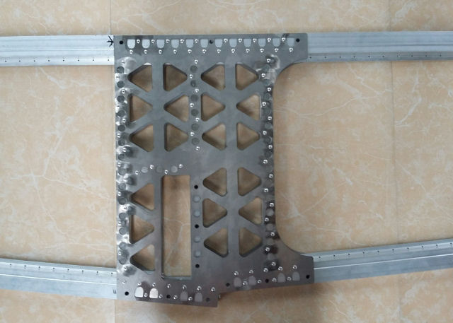

bexrbetter Posted May 24, 2016 Author Share Posted May 24, 2016 So no option as a taildragger?If you came up with a way of making the plate symmetrical, you could just reverse it for tail wheel set up. I have the tail'dragger plate on file, it's basically the same but the step reversed. So anyway, this morning had the new nose, new tail and slightly optimised center plates cut and couldn't be happier with the result. Note the nose plate will fold around the corner to support the firewall but is not folded yet in the pictures .. Very happy with the weights also, below target and lower than original concept. 4 Link to comment Share on other sites More sharing options...

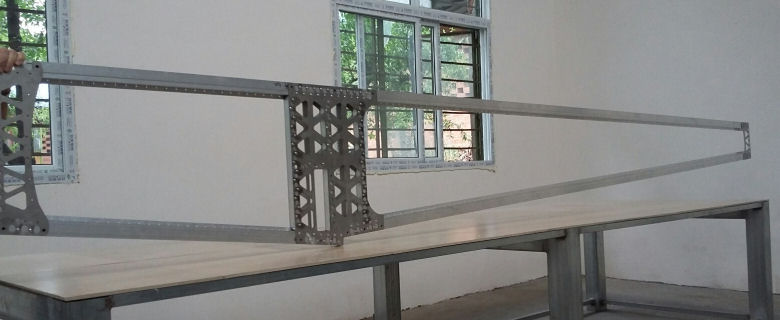

bexrbetter Posted May 25, 2016 Author Share Posted May 25, 2016 Today was important to me because I got the completely unskilled lad and another guy who has some trade skillz, albeit in another unrelated area, to put the other side together all by themselves. I wasn't at the factory and I told them under no circumstance were they allowed to contact me to ask questions. I asked them not to try to rush. 3 hours it took them working it out as they went and I am pretty happy about that. There's a lot more going on between the 2 main center supports than you can see in the pictures btw. Point being that I wanted to see if it really is as easy to someone else as it is for me, apparently it is. (Note that the front supports are yet to be bent around for the firewall) 3 Link to comment Share on other sites More sharing options...
