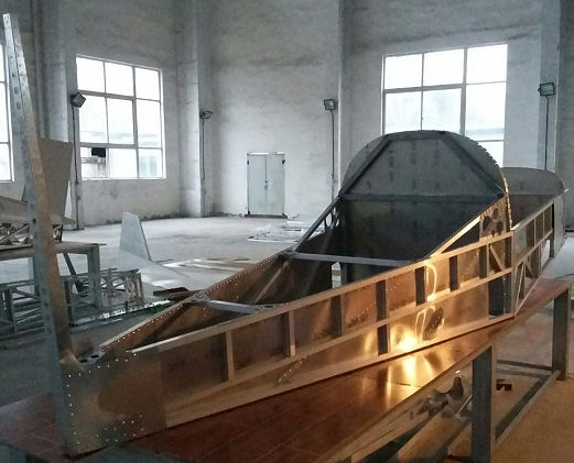

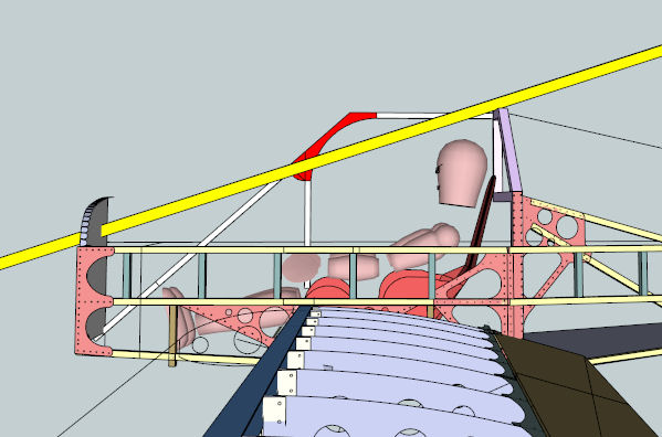

Sorry Bex - don't take this as a personal affront - but personally, I just can't warm to that single-central-beam design.
I know what you're trying to achieve, but I think it needs a different design to increase cabin strength, from what appears to me, to be inadequate support for the top of the cabin.
I'm reminded of the weakness of many aircraft cabin designs - particularly those with large viewing areas - when I look at the wreckage of the Sling 4 that crashed, and see the virtually total destruction of the cabin.
I look at that little machine and think, "what would a Jabiru cabin look like after a crash like that?"
IMO, as regards a totally new design, one should aim for a substantial safety cage for all occupants. Just my 0.002c worth here.
'Mind-boggling': Urgent surgery for self-built plane crash pilot
Did you not notice the proper steel ROP roll bar behind the Pax heads? It's substantial (and not final either). Safety was always paramount and at 1.1 meters in height, you will be able to almost walk from under the plane there is that much clearance.
Maybe you just didn't notice the roll bar before?
I have been very dismayed at the lack of attention shown to this safety item, some of the roll bar attempts are a joke. Feel sorry for that guy and his Niece who flipped the Vans a few months back and were trapped for 2 hours, with life long injuries that should have been so easily avoided. Being trapped without injury is one thing, fire is a real threat from there.
The "center beam" as you put it, is not a roll bar, it is there for 2 other reasons,
One, to hang your full body weight from getting in and out, you can't see but there's 2 bolt holes for a hold strap for the purpose,
Two, to hinge the canopy hatches from,
and Three - what do you want, I told you there was only two reasons.
The yellow line here is what we call the "Broomstick Test", and there is no way you are surviving any forces beyond what it would take to crush my craft past that yellow line.
I take the safety features of my plane very seriously such as the 200mm crush area under your azz to help protect your spine, the steel front corners (seen in pink above 3D) to dissipate energy up the frame rather than tearing there, many little thoughts similar. The roll bar crossbar is the correct height for seat belt harnesses by design, not accident, etc, etc.

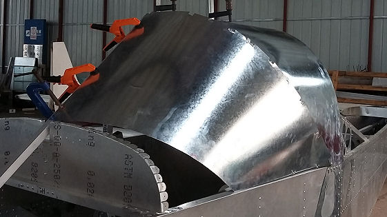

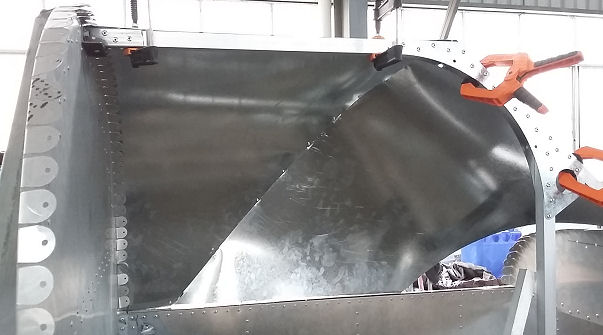

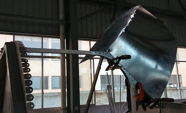

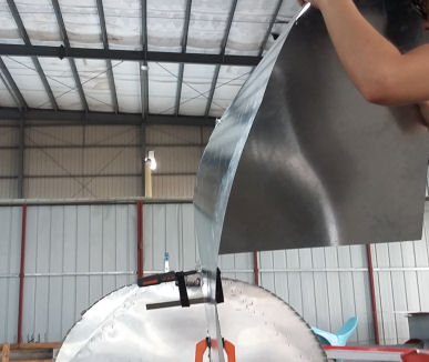

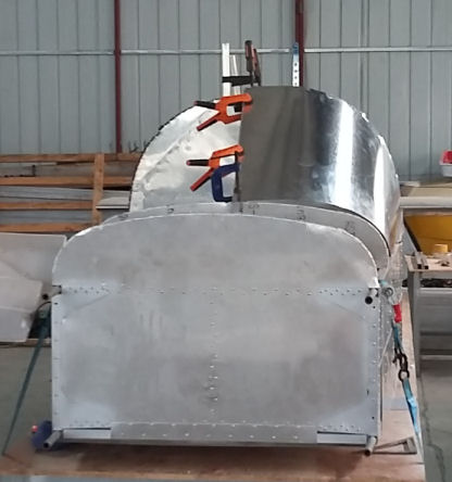

Most of today was spent cutting a sheet of tin up to make a pattern for a flat wrap canopy as well as experimenting with hinge positions, things went quite well and got a result quite quickly, alas the sheet of clear plastic I have had laying around for a while proved to be rubbish (brittle) when I transfered the pattern and started to cut it.

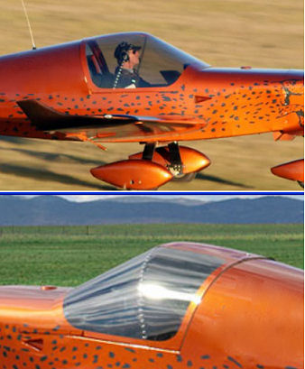

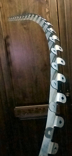

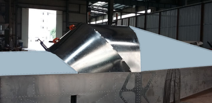

Anywayz, this strange looking creature is the joining strip for the 2 flat wraps, and here is the canopy style I am hoping to replicate ..
  • Like 8
I reckon the canopy looks good, and it leaves the possibility for a blown one as an after-market thing for those who want a more expensive one. Personally, I would stick with the 2 single-curvature bits canopy.
And the wings look ok now, sorry about my comment about the tips at one time. The comment came from a particular perspective drawing which gave me an illusion that the tip chord was too big.
And the wings look ok now, sorry about my comment about the tips at one time. .
Oh you say sorry now, but where were you when I sobbed myself to sleep all those nights alone?
Neat, but how are you going to seal it against rain and wind noise?
With Acme rain and wind noise sealer.
  • Haha 4
Remember, this is a Chinese product built to a market price level. There will be a rain and wind noise sealing option, but it will set you back another $3000. 003_cheezy_grin.gif.c5a94fc2937f61b556d8146a1bc97ef8.gif
