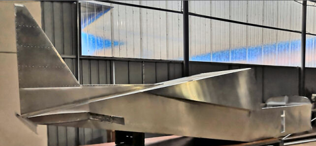

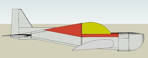

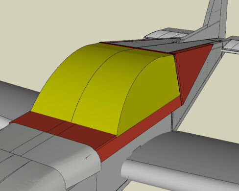

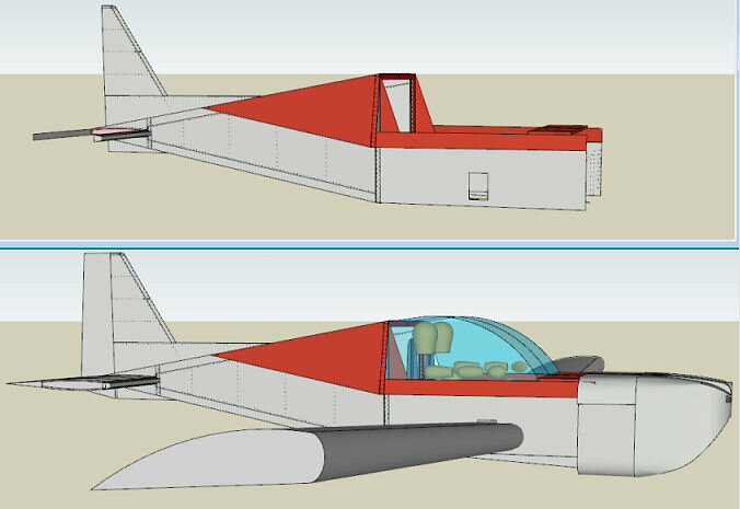

Be interesting to see how you do that canopy since the rear fuse is flat sided and not rounded.

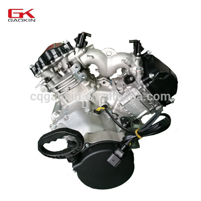

As you are in the same neck of the woods as Chongqing, I wonder if you know anything about GK (Gaokin) engines, and/or the company, like this : 4 stroke liq cooled v-twin 850cc 65HP (reported) 42kg bare.
Also, any idea of freight costs from there to Brisbane ?
I first went to Gaokin almost 10 years ago when they were setting up to assemble the 650cc single. I have been there again since. The engines are of AVL Austria design, they only assemble them, components are made somewhere else in China, and the components shared with a few other companies who do the same. They have a 80hp  1000cc VTwin also. Their engine sizes are of no interest to me for my projects. Have no idea of freight costs.

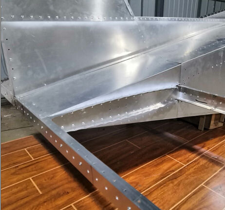

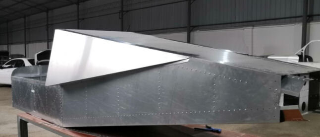

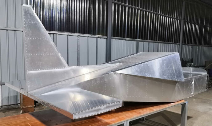

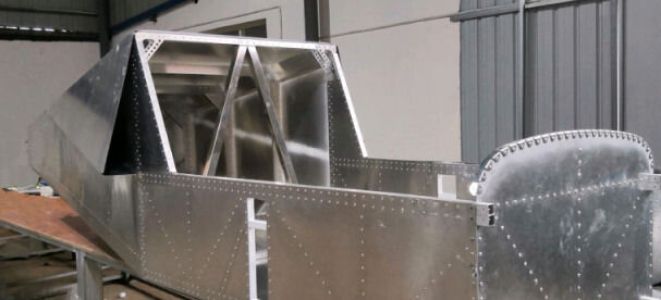

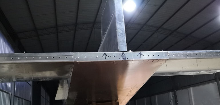

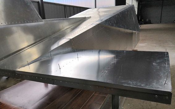

HS Skins on, bent and drilled by hand as all the shops are closed for the holidays. Happy my metal working skillz are still there.
Held on by a few rivets while I make decisions about the D-box and Elevator hinges.

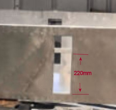

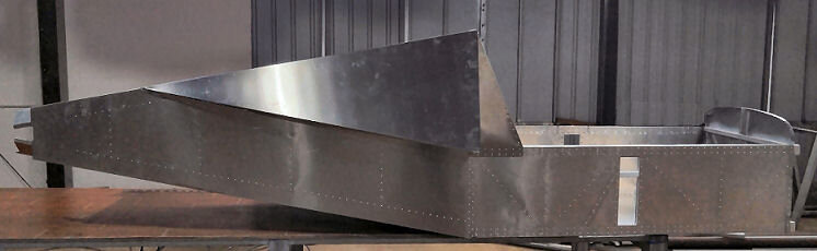

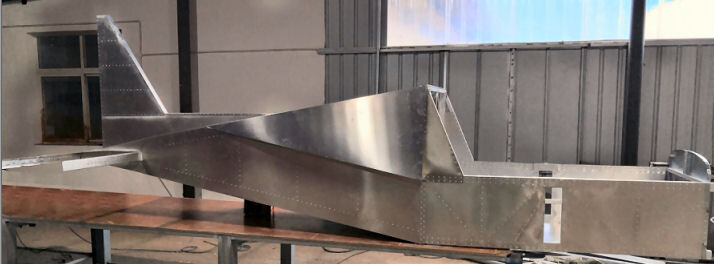

What's the purpose of the vertical slot on each side of the fuselage? Good to see the project is still making progress.
Carry through for spar box?
Hey Bex, looking good.
I had a shave.
How are you planning to hinge the elevators?
Yup, same as a Morgan, Vans RV12 ect ..
Thanks. It just looked very deep for a wing spar.
It looks like a 70's Volvo. As they said about them - "it should look good, once you get it out of the box!" :cheezy grin:
Interesting the comments I've had when you consider Whittman, Murphy, Davis, Bede ect, and of course the best selling Zenith 700 series ..
One guy is referring to it as the "Tesla Cyberplane" ..
  • Haha 1
My spar box is exactly that 200mm 6061 t6 ,goes through fuse and 350mm stubs outside with the wing dihedral starting there at 3 degrees , 6bolts holding wings to spar box and spar box is held in place with 8 more bolts AN5s
