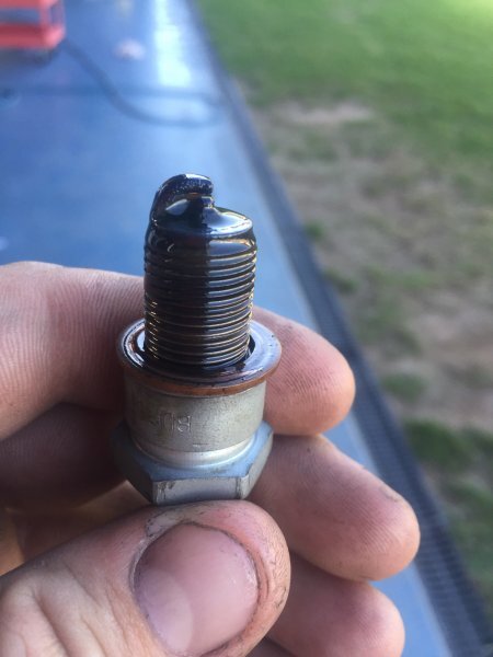

The bridging is called whiskering on two strokes. The oil will be there if the cylinder isn't firing. The insulator can short out as well without the bridging . Lubricant additives are metal salts and can coat the insulator. Most just replace rather than abrasive blast and regap these days. Might be an idea to look in that cyl with a boroscope Nev

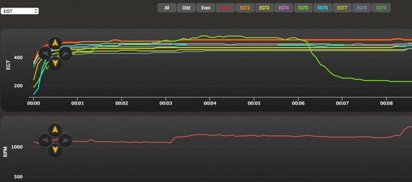

D.R. What device(s) do you have for recording the engine data? Seems like pretty impressive gear.
Inverted engines will - mostly - have this problem at some time. Gypsy's were notorious, and it didn't always happen on start-up. My brother had to land on the only croppie strip on Razorback one morning on the way to work at Bankstown, to clean the plugs. The farmer who owned the strip came out to ask him if he was OK; since he didn't have any chocks aboard, he asked the farmer to hold the tail while he started her up again - which the farmer did, and as soon as it fired, let go! Luckily, it was an Auster, so brother was able to scramble aboard... being late to work, he hurriedly tied it down outside deHavilland's and went to work; mid-morning, one of the workshop crew came up after smoko and asked him if he'd like them to remove the bits of tree from the u/c, or did he want to take them home as a trophy?
Quite seriously - is it worth taking the bottom two cylinder plugs out and screwing in blanks (or even better, inhibiting plugs) if she's going to be sitting around for a while? I know that Mark Willard - I'd imagine you know him - does a fair bit of work on the Chinese version of that engine for the Namchang crowd, he may have some ideas for you?
JPI EDM 740. This picture (not of mine) gives a deceptively large impression of its size. It's quite compact, which I needed due to lack of panel real estate and limitations of what was available at the time. With 9 cylinders displayed it can be a bit of information overload. A double-edged sword in some respects. The company is a total pain to deal with in my experience, but the equipment is good quality. There are better compact engine monitors out there now.
Attached also is the data stream for EGT and RPM (on SavvyAnalysis you can select any monitored parameters for display and comparison when you upload the data) showing the taxy across to refuelling. EGT #5 is quite erratic, presumably the early signs of fouling, until it drops off at the 6 minute mark. That erratic movement would not be noticed with the resolution of the display, and I have to say I also never noticed it drop right off as I was too busy watching outside.
I don't believe so. This aircraft is equipped with a very good electric oil scavenge system which pumps residual oil back to the tank after shutdown. The engine also has modified pistons and rings and leaks/drips far less oil than, say, a Yak or similar. We have consulted with our resident M14P engine expert over in the USA and we think the fouled plug problem has been a ground handling technique issue on our part. He has advised that we need to "aggressively lean" the engine on the ground to lower the chances of this occurring. We were not routinely doing that.

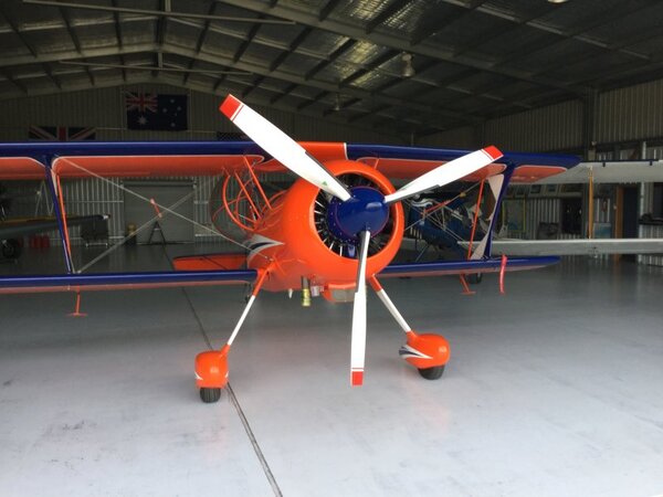

out of curiosity, what type of engine is this?
Sorry I missed your post.
This is a Russian Vedeneyev M14P 9 cylinder supercharged radial. It has been modified by a US aero engine overhaul company called Barrett Precision Engines. Those mods include new pistons and rings to increase compression and power, and reduce oil consumption. Also they replaced the Russian carburettor which works well, but is increasingly difficult to get parts for, with an Airflow Performance fuel injection system. The other main item they replaced was the Russian magnetos (and massive but not so reliable spark plugs), with an electronic ignition system and auto plugs. Again, the old mags are hard to get replacement parts for. With the upheaval and disintegration of the former USSR, production of the engine ceased and a lot of original tooling was destroyed or lost. So new spares can be hard to come by, with most found from "old stock" sitting in the dusty dark corners of old hangars etc.
The design harks back quite some decades, and it is renowned as a very solidly built "pilot tolerant" radial engine with a very impressive power to weight ratio. Curtiss Pitts designed this aircraft around this particular engine.
The "stock" Russian M14p is 360 HP. They also produced a 400 HP version (M14PF) by gearing up the supercharger.
The Barrett mods take a stock 360 HP engine and turn it into a 430+ HP engine (without changing the supercharger) through the increased compression, fuel injection, and ignition systems. Engineers believe the basic design to be quite capable of taking 450+ HP and they've run it at these powers on their test stand with no issues. However MT Propellers in Germany refuse to warranty their 2.6 metre props for that much power.

Wow, DR, that's one heck of a hot-rodded engine!, and absolutely, at that spec, I'd only be talking to the 'maker' also!. Good to see her sitting pretty in Dave's hangar this morning, with a clutch of smaller Pitts ( Pittlets? A rash of Pitts?) around her. Dave said she doesn't drop ANY oil, well, maybe one drop - amazing!. Dave did say he 'was a bit concerned', but then Dave is pretty unflappable...
I saw that my "old" Pitts S-2A is in Dave's hangar for its annual, right next to DR's airplane.
