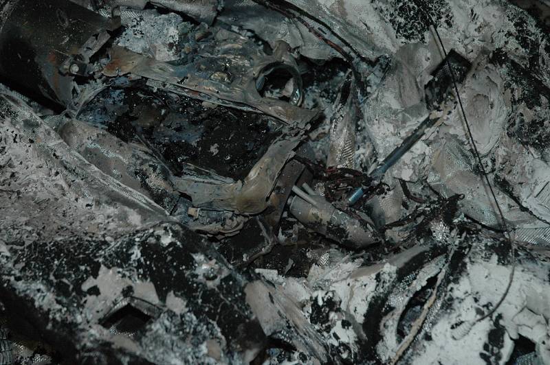

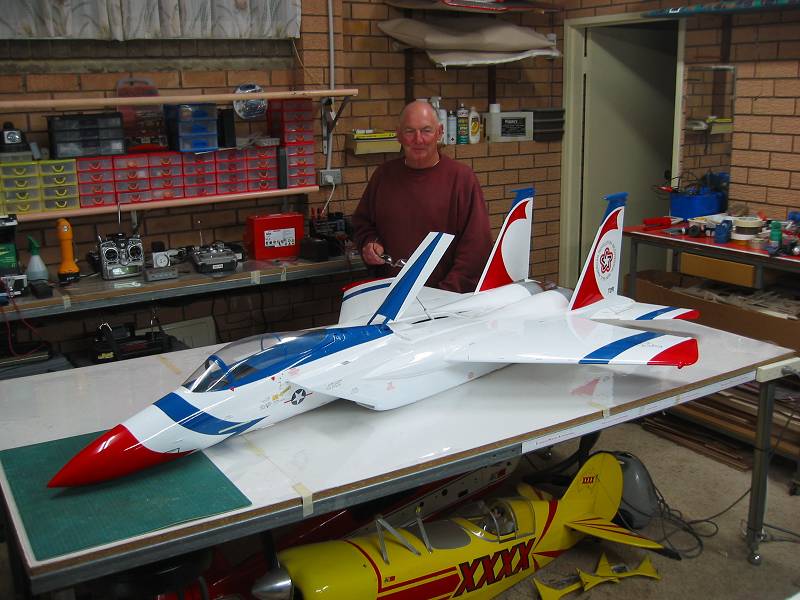

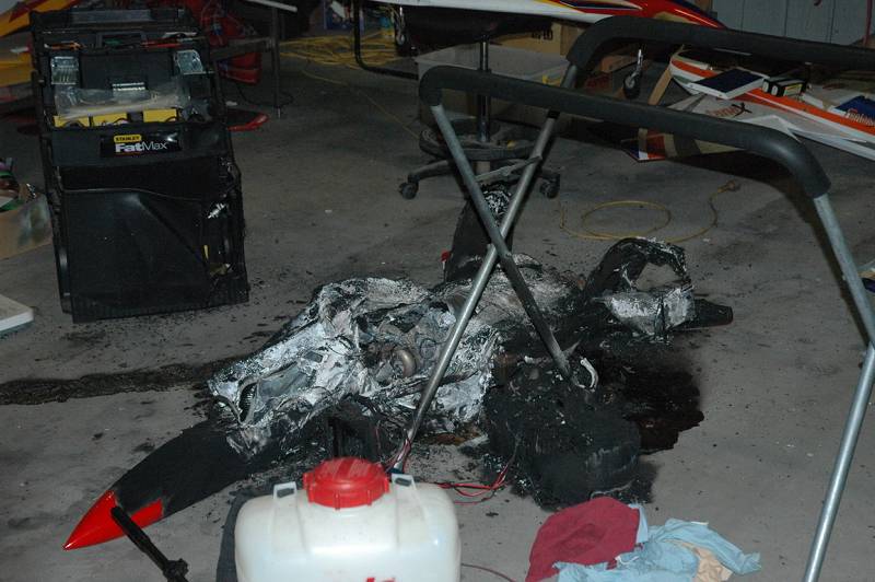

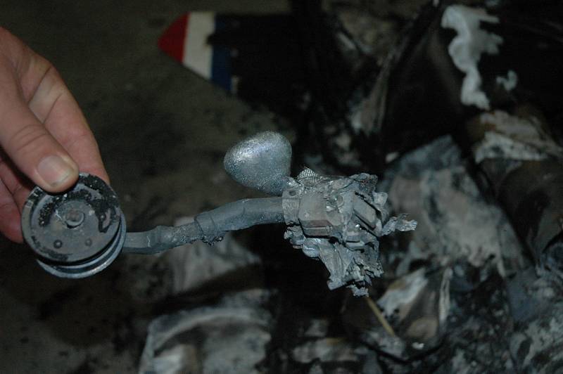

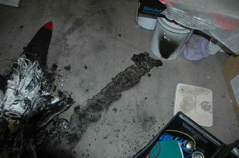

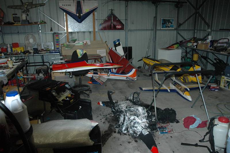

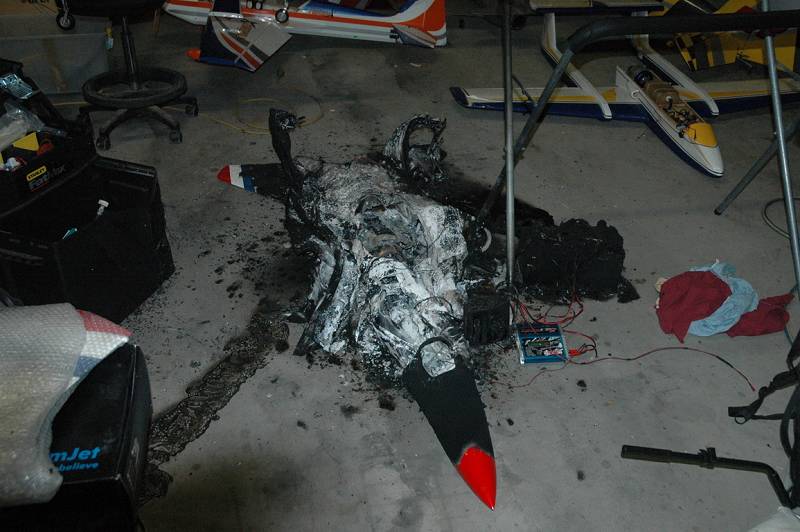

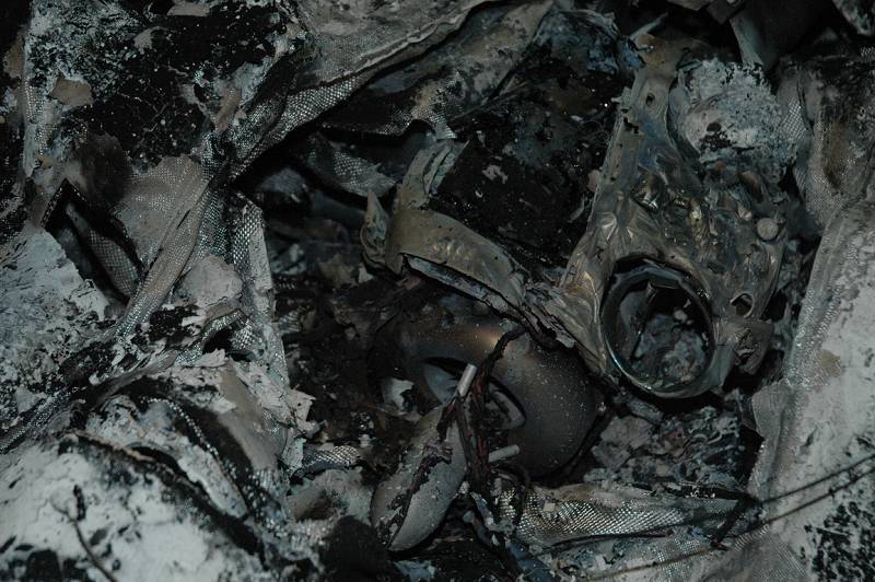

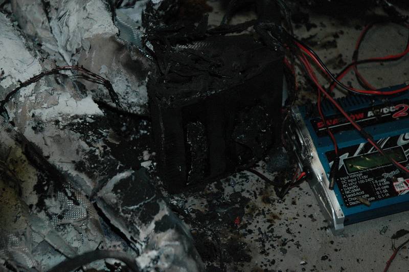

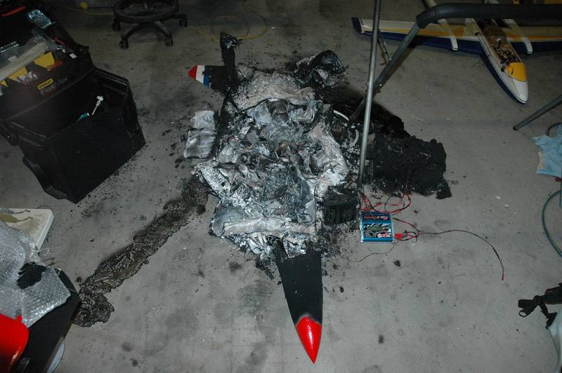

Kyle Communications Posted May 22, 2016 Posted May 22, 2016 Bruce I have to disagree. I have seen this with my own eyes as I was there 30 mins after this happened and I took these photos. I removed all Lipoly batteries from my turbine models after this incident and have only ever charged the Lipoly batteries outside the model and in the open away from anything that can catch fire. I use them in electric RC models and thats all. My jets are all powered by LiFE batteries and 98% of other jet guys are the same. This is a mate of mine who had a beautiful Avonds F15 with a Simjet 16kg thrust turbine in it. It had only 1 Lipoly battery in it and it was used for the fuel pump battery. The night before its maiden flight all the nicad batteries and the 1 Lipoly battery were being changed. The brand new Futaba transmitter just happened to be sitting on the top of the model as well. The transmitter was a new MZ some $3000 worth and the model was worth around $20,000. The one Lipoly which was a new battery and had been previously charged as the engine had been run several times before to test all the systems etc so it wasnt as if it hadnt been used before. My mate put it on charge and went into his house to have tea...after he had tea about 45 mins later he went back out to the shed and this is what greeted him. In the ashes you can see what is left of the turbine and also you can even see the outlines of the transmitter sticks. Can you imagine if this happened inflight while you are in the aircraft. It is a 4000 deg magnesium style fire 1
Bruce Tuncks Posted May 22, 2016 Posted May 22, 2016 yep that's convincing Mark. Sorry about that beaut model.
Kyle Communications Posted May 22, 2016 Posted May 22, 2016 Those pictures I posted on RCUniverse thread many years ago. It was the start of a lot of people around the world getting them out of their models when charging them so it would not happen to them. I just checked the old post it was done on 18/3/2009
