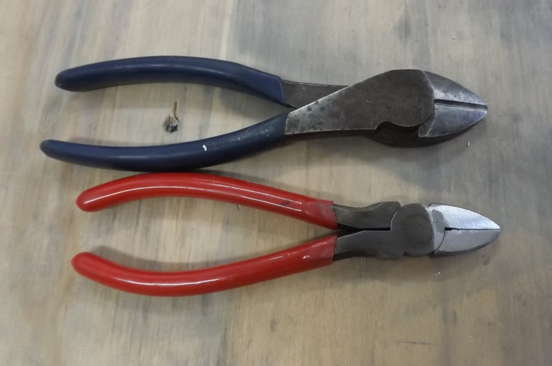

IBob Posted January 19, 2017 Author Posted January 19, 2017 A pair of sidecutters, (the red ones) ground so that the cutting edge sits flush to a flat surface. These are very good for removing rivets when you can get to both sides of the job: First carefully drill off the rivet head with an oversized bit. Then go round the back and take hold of the rivet, flush to the sheet metal, with the sidecutters. No need to squeeze hard, you're not trying to cut it off. Now rotate the rivet a little in the hole and it will generally come out very easily. I read about this method early in my build, and it's so easy I wish I'd ground the cutters then too! 1

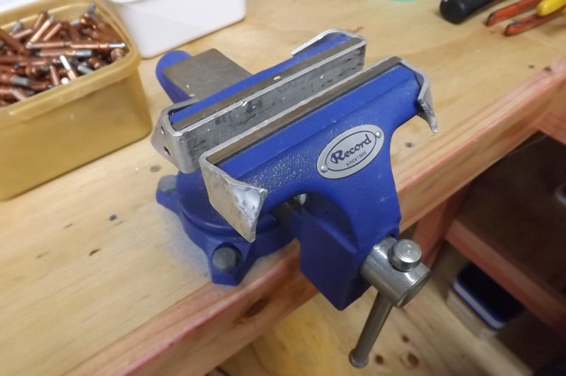

IBob Posted January 22, 2017 Author Posted January 22, 2017 More bits & pieces: Cheap vice with DIY softjaws

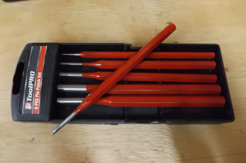

IBob Posted January 22, 2017 Author Posted January 22, 2017 ...cheap set of metric pin punches. The one on top is 4mm and I have tapered the end. It makes a great podger for the A5 rivets, as suggested here by Mark many months ago. 1

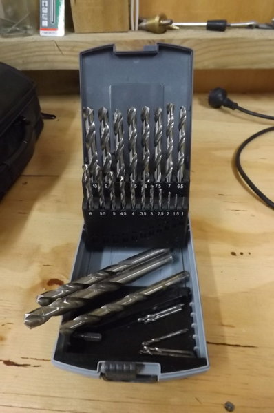

IBob Posted January 22, 2017 Author Posted January 22, 2017 Half decent set of metric drills, for aircraft use only. I have the usual sad DIY assortment of drills, with the one you really want always broken or missing. Decent drills aren't cheap (and the cheap ones are rubbish), I put this off for a while. So they are another thing I wish I'd bought sooner.

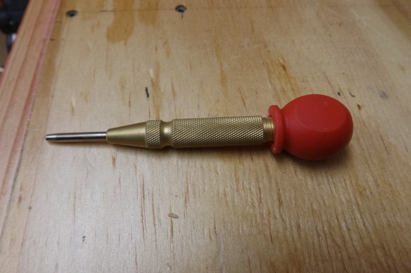

IBob Posted January 22, 2017 Author Posted January 22, 2017 Cheap automatic centrepunch. No hammer required, just press it down until it goes click (or clunk), so one-handed use. Get an adjustable one, this one adjusts by turning the knob. Most of them are made for use on steel, so a bit brutal for aluminium. I took this one to bits and modified the springs for softer action.

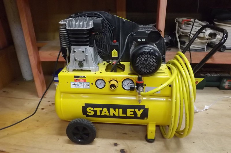

IBob Posted January 22, 2017 Author Posted January 22, 2017 Not the cheapest compressor, but I've been really happy with this: 190cfm, plenty of capacity for both riveting and spraying, only cycles on occasionally when riveting. Belt drive for quiet operation: direct drive compressors (or the ones I have heard) make a horrible noise.

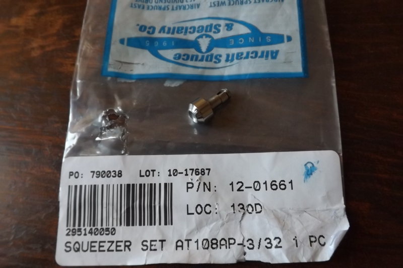

IBob Posted January 22, 2017 Author Posted January 22, 2017 Quote Just wondering, what tools do I need to buy. Some things seem to be nonexistend on the german market.Do I need a Rivet Squeeser? (tried to put this a search into the german ebay and amazon page... no result...) The hand rivet squeeze is used only for the trailing edges of all the flying surfaces. These can be done at any time (although it's less handling to do the wings while they are on the bench) so not having the squeeze does not hold up the build in any way. I did all my flying surfaces at the same time, on completion of the wings. They are quite cheap from outlets like Aircraft Spruce. HAND RIVET SQUEEZER from Aircraft Spruce However, I borrowed a set from a local LAME. I then bought the snap (the die that goes in the squeeze) to fit the rivets as specified in the manual. I then found that the rivets supplied were different (did not fit the snap), and having watched others with a lot more experience than myself try to use them, I purchased 1/4lb (love those imperial measures!) of the rivets as specified in the manual. They cost very little, and 1/4lb is probably enough for 2 Savannahs. I then drilled some scrap and put in a few practise rivets while setting up the squeeze (you set up how far it squeezes). Having done all that, and worked out how to use the bench edge as a guide for aligning the squeeze (as described elsewhere), the setting of these rivets went very easily. I am very happy with the result (perfectly straight trailing edges and all rivets appear identical) and found this part most enjoyable. (If I was doing this again, I would buy shorter rivets, as well as the specified rivets. I think the length as specified is only necessary at the rudder TE, where there is an insert between the skins, with trim tab. All other TEs are just 2 skins joining, and a shorter rivet would give a neater finish still.) PS. If you buy a set, get them with a deep enough throat to work at the rudder trim tab. The rivets are set in 45mm from the TE of the trim tab. 1 1

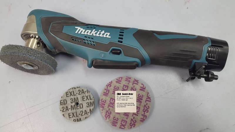

MajorTom Posted January 27, 2017 Posted January 27, 2017 I'm wondering if this will work for deburring. After a long fruitless, search I found some 2 and 3 inch scotch bright weels. The angle drilling machine (don't know how you call it in english) is 900 rpm.
IBob Posted January 27, 2017 Author Posted January 27, 2017 Quote [ATTACH]48006[/ATTACH]I'm wondering if this will work for deburring. After a long fruitless, search I found some 2 and 3 inch scotch bright weels. The angle drilling machine (don't know how you call it in english) is 900 rpm. In English that is an angle grinder. You may find it easier (and quieter) to use a bench grinder, either that or fasten the angle grinder to the bench in some way so that it cannot move? You can also buy the (red) scotchbrite pads, and use them by hand. There is some fairly detailed conversation around deburring earlier in this thread, starting about here: Savannah S Build Notes - Some Tools
