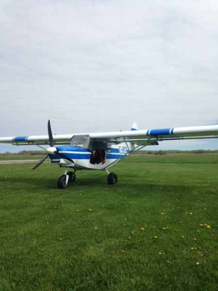

Neil_S Posted July 1, 2016 Posted July 1, 2016 Quote Hi allInterested in what everyone's Savannah weighs. Redid mine after changing tyres to 21/800 mains and 600/6 nosewheel, now weighs 305kg giving me 255kg useful load. Peter Mine is factory built S, Rotax 912 ULS, no chute, 6" tyres, 310kg empty weight. Cheers, Neil

rankamateur Posted July 3, 2016 Posted July 3, 2016 Quote Mine is factory built S, Rotax 912 ULS, no chute, 6" tyres, 310kg empty weight.Cheers, Neil And a nice paint job! 1
