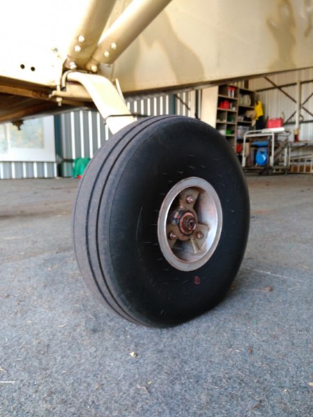

Actual tires :
Main : Condor - 6.00-6 4 Ply --> Photo Original.jpg, Main Original Condor.jpg
Front : Trelleborg T-510 - 13x5.00-6 --> Photo Front --> Original.jpg

So one of the actual main wheel (Condor - 6.00-6) will replace the front wheel ( I checked the clearance and it should fit).

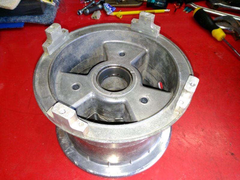

Is there anything I should know about replacing the actual front rim with the new one regarding bearing size ?
Also I could not find the reference of the bearing used on the main rim and front rim ?
Would any of you have a part number for the bearings used on the main and front rim ?

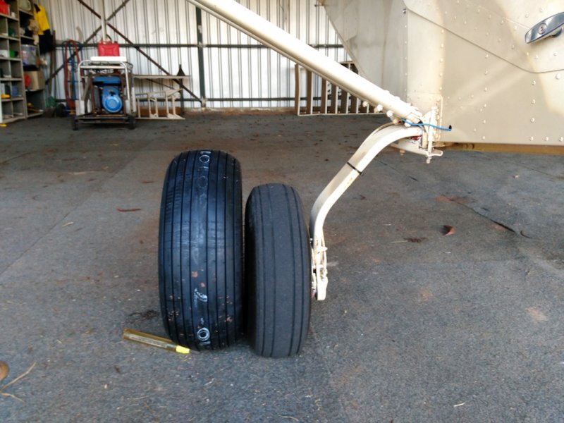

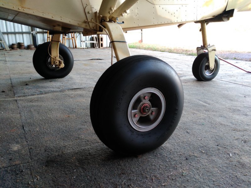

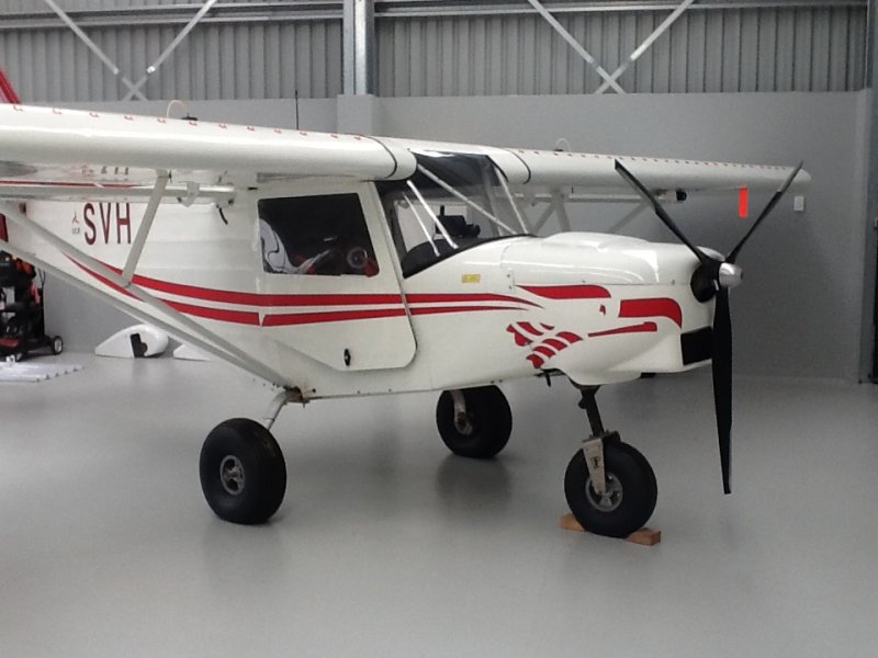

Hi Xavier
I have the same combo on my VG.
Replaced the previous spatted 15/600 x 6. Drilled out the old fork about 15mm lower.
Did new weight and balance, added a fair bit of weight but Cof G change was negligible, only a few millimetres.
Overall the improvement fantastic, able to get in and out of places that were impossible previously. Before and after pics.
Peter

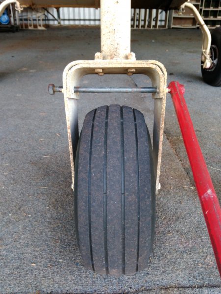

Your front fork looks to have already been drilled lower but you will need to get rid of your towbar bolt. That done a Condor will fit with a standard rim.

Hi there i made sleeves to change from roller bearing to sealed ball bears , i think the ones i used were 3/4 od to 1 5/8 od . I have a the aero trainer on front with axle 15 mm lowered and have the 8.00 x6 turf gligers on the back on my savannah ,i think is the best of bolth worlds . The main are great on the bumps but you can use low pressure and not over big in Od of tyre when you go to the next size up on 701 you have to go to the twin caliper brakes on each wheel .

Well it took a while but wheels are upgraded. Aero Classic 8.5-6 mains and Condor front. Waited until I had finished X-C training just in case cruise speed and fuel burn were going to be an issue.
Bit of fiddling involved: re-drill front axle hole, new 12mm holes for the valve stems on main wheels. And of course the very primitive main wheel situation of having to reassemble and repack wheel bearings every time you take wheel off. Not to mention disc rotor attachment screws that were seized and had to be drilled out.
All good now. About 6-7 psi in mains which is keeping them round even when loaded and not enough to make tube bulge out of original central valve stem hole.
Aircraft rolls much easier over rough ground. Have not yet flown because of adverse winds at my high country airstrip (3700'). Also missed Narromine fly-in :-(
Putting the 6" tyre on the front alters the nose down attitude it sits with which I consider a good feature, particularly in strong gusty winds. You can control the weight on the nosewheel by how you fly it.. Nev
