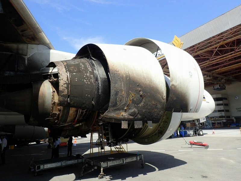

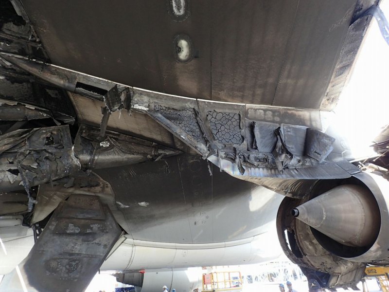

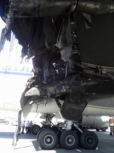

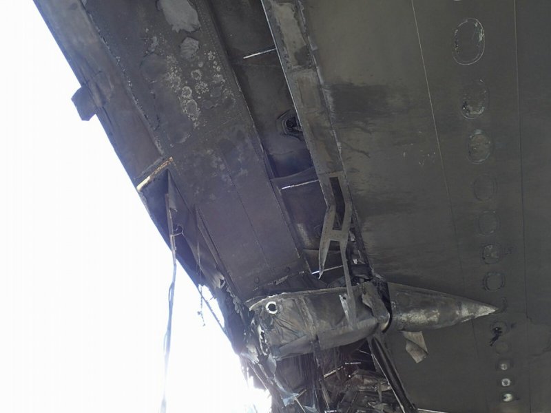

dutchroll Posted July 8, 2016 Posted July 8, 2016 Happy snaps of the SIA B777 aftermath. Word on the street is that it was actually leaking fuel which ignited upon landing.
johnm Posted July 8, 2016 Posted July 8, 2016 if lets say it was a fuel fed engine fire (I'm not assuming it was) .......................... is there a fuel cut off to starve fuel ?
dutchroll Posted July 8, 2016 Posted July 8, 2016 Yes. If the engine is shutdown in flight, fuel will be cutoff at the spar valve. My understanding is that this engine was not shutdown.
Bennyboy320 Posted July 8, 2016 Posted July 8, 2016 And if the damage is upstream of the LP or HP fuel valves you can't stop the fuel leak, assume Boeing are similar to the Bus.
facthunter Posted July 8, 2016 Posted July 8, 2016 From the "Plumbing " point of view the fuel is able to be isolated at each fuel tank, It can also be shut off at the engine itself which is done in a "normal" engine fire procedure.. Was that engine still idling? No smoke/flame came out the front. The fire spread all along the wing at the leading edge flap position. How does THAT happen? That plane will be AOG for a long time. Nev
dutchroll Posted July 8, 2016 Posted July 8, 2016 I believe they came back with thrust reduced to idle. In a Boeing, fulling the engine fire handle, or moving the fuel control switch to cutoff, will close the spar valve and prevent any fuel flow to the engine. This doesn't solve the problem of a fuel leak in the wing area, but if it's in any of the engine plumbing including the first & second stage fuel pumps, the fuel/oil heat exchanger, etc, it will cutoff the fuel leak.
