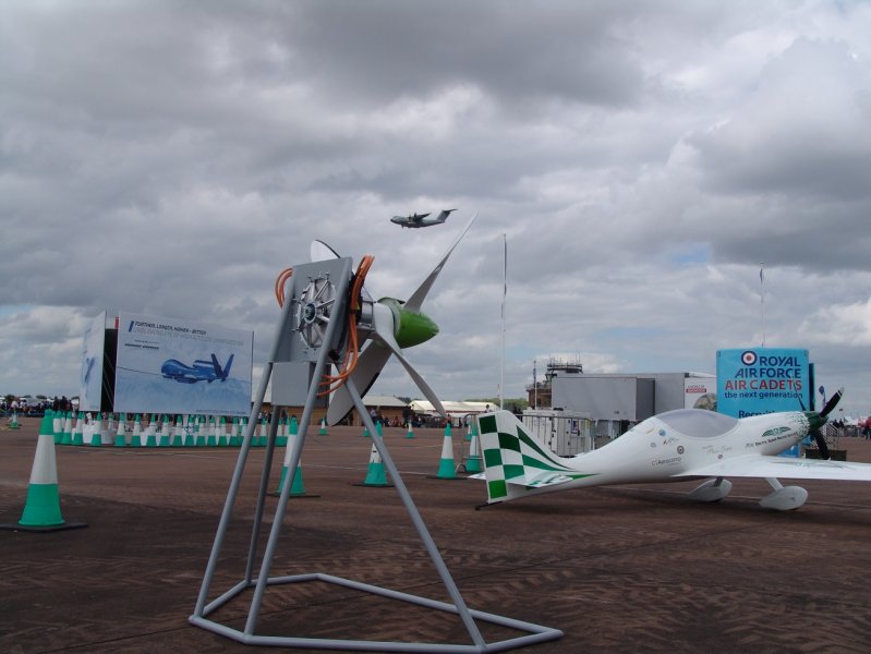

Marty_d Posted July 13, 2016 Posted July 13, 2016 Some info from the people featured in that video: Hi Marty, The answer is yes, we will move to offer a commercial 300hp electric contra rotating propulsion system in the future. Some late series Spitfires as you no doubt already know were fitted with the Griffin powered contra rotating propeller arrangement and proved highly successful performance wise but being ICE powered was tremendously complex and needed a military budget to build and maintain them. Have a look at www.contraelectric.com which will give you more information on the development although the site is a little out of date – we will be updating it shortly. We are hoping Robert Llewellyn will do a second Fully Charged program covering the ground test program of the CRPS unit which will commence in the next few weeks. The attached photo shows the prototype CRPS at the Royal International Air Tattoo at RAF Fairford recently. Best regards, Nick Sills. Electro-flight Ltd. Contra Electric Propulsion Ltd. The site www.contraelectric.com is very interesting. Below is the photo they attached. 1
