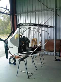

The Back Half. The worst damage was to the tops of the two upright legs you see in this photo.
The left one is bent at 90 degrees
The front half. Nose leg bent, not badly but still bent.
[ATTACH]45356[/ATTACH] [ATTACH=full]45356[/ATTACH]

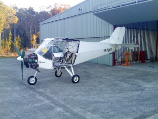

Despite the damage and the apparent weakness looking at the wheels, the wheels themselves stood up very well.
The axles and axle mounts were changed however.
[ATTACH]45357[/ATTACH]

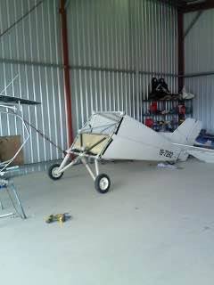

And when the engineer knows what he is doing it goes back together as well.
[ATTACH]45358[/ATTACH]
