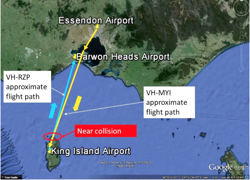

Garfly Posted July 27, 2016 Posted July 27, 2016 http://www.atsb.gov.au/media/5770910/ao-2016-017-final.pdf

facthunter Posted July 28, 2016 Posted July 28, 2016 Possibly as soon as you are out of the circuit area, in circumstances like those. On almost reciprocal tracks it's especially dangerous. GNSS makes everyone track more accurately. Stay away from common tracks that people climb and descend on when your level is in amongst the likely profiles of the other aircraft. The only safe method is to visually sight passing traffic, maintaining vertical separation until you do. Not continuing the descent in this instance made it more dangerous. Any descent below 6500 should be considered unsafe till the aircraft have passed each other or they agree that visual separation can be achieved and maintained safely. Nev
johnm Posted July 28, 2016 Posted July 28, 2016 There should be an agreed understood rule that you fly right of track - though in this instance may not of helped ? - fly a mile or 5 off track - irrespective of the vertical separation thingy
facthunter Posted July 28, 2016 Posted July 28, 2016 I have always tried to fly OFF track when not in controlled airspace by about 10 miles where a set of waypoints has busy aerodromes with climbing and descending traffic associated with them. Having it to the right ( say) keeps opposite direction traffic separated like you have at some lanes of entry. Maintaining vertical separation till visual passing confirmed, or distances established by DME/radar seems to have been and maybe still is the most positive method, requiring both to have established radio contact between themselves or a ground station coordinating. Thinking it's a big sky doesn't cut it. Nev 1

aro Posted July 31, 2016 Posted July 31, 2016 I don't think the Cessna pilot did anything wrong. They seemed to make all the calls you could ask for on the radio. The main problem was the RPT missed hearing some calls despite having 2 radios, presumably while they were making their own calls on CTAF. There seems to be 2 main problems: 1) The RPT made an assumption about where the Cessna would be (below the layer of clouds) 2) ATC assumed the RPT would hear all the Cessna's radio calls. "Traffic is Cessna 150 RZP reported climbing to 5500" would be better than "Did you hear the call from RZP?" You really need to know what they said before you know if you heard it. It appears that they didn't hear the call ATC was referring to, only other calls.
facthunter Posted July 31, 2016 Posted July 31, 2016 The info on level re the C-150, tells the RPT that below a certain height he has to satisfy himself that it is safe, because the other aircraft is "somewhere down there" so proceding below say 6500 safely has problems. You know the other aircraft is on a roughly reciprocal track also so your vertical separation is paramount till both aircraft have passed and confirmed that fact. Other assumptions re cloud amount and what the other pilot will do in relation to it are just assumptions and unless you are sure, you are NOT sure. Nev 1

ben87r Posted July 31, 2016 Posted July 31, 2016 Obviously wasn't there so I will keep my comment brief but I would be very hesitant to continue descent through another AC reported level without knowing that I was past their reported distance OR they had reported maintaining 1 or more miles off GPS track OR they were N/S/E/W of a location/feature and I was on the other side. Still being in/above IMC only the first two would apply here. On another note most PPL/RA guys normally give a good amount of room for the commercial/rpt boys and girls if they are uncomfortable dealing with the separation especially with IFR traffic which is greatly appreciated and may not be thanked enough. Not to say that it wasn't the case here.
aro Posted July 31, 2016 Posted July 31, 2016 Aircraft 2 was identified as a RPT inbound to King Island, but only the 2 aircraft involved in the incident were identified by call sign. From the report: the crew of a regular public transport (RPT) aircraft (’Aircraft 2’) also broadcast on the CTAF. The crew advised that they were at 30 NM inbound to King Island and on descent through FL 115.3 The pilot of RZP responded to this broadcast, and reported RZP’s position and their intentions. After a brief radio discussion, the pilot of RZP agreed to advise the crew of Aircraft 2 when RZP was close to the northern coast of the island (Figure 1). The crew of Aircraft 2 had temporarily stopped their descent at 6,500 ft until they could confirm that they had safely passed RZP Seems clear. The aircraft are identified in the order they made the first significant radio calls. Aircraft 1 = the Cessna RZP. Aircraft 2 = RPT inbound. Aircraft 3 = Second RPT inbound MYI. Incident was between Aircraft 1 and Aircraft 3. Reading the report again, there seems to be a lot of "Where are you?" type calls going on even between the 2 RPT. To me it suggests a problem with self arranged separation with more than 2 aircraft. With all the calls going on across 2 different frequencies, MYI never actually found out what RZP was doing (even though they told ATC they had the information - they didn't know about the calls they didn't hear because they were transmitting). Obviously wasn't there so I will keep my comment brief but I would be very hesitant to continue descent through another AC reported level They didn't hear the reported level. They did choose to stop the descent, unfortunately it was at 5300 when RZP was climbing to 5500. 1

ben87r Posted July 31, 2016 Posted July 31, 2016 They didn't hear the reported level. They did choose to stop the descent, unfortunately it was at 5300 when RZP was climbing to 5500 True, but they did descend through the last level maintained by aircraft 2 after becoming aware of traffic without assured separation. I would have wanted to have spoken with them before further descent. 1
