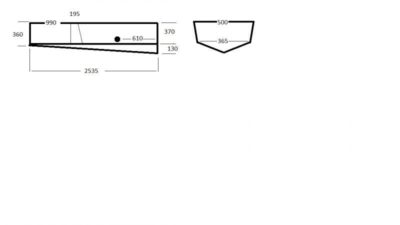

Scott Taylor Posted August 4, 2016 Author Posted August 4, 2016 I have a few more dimensions of my Flea Fuse see attached. If any can identify it would be a great help. Regards 1
kasper Posted August 4, 2016 Posted August 4, 2016 I have a few more dimensions of my Flea Fuse see attached. If any can identify it would be a great help.Regards Closest match is HM360 or a slightly stretched HM293 1

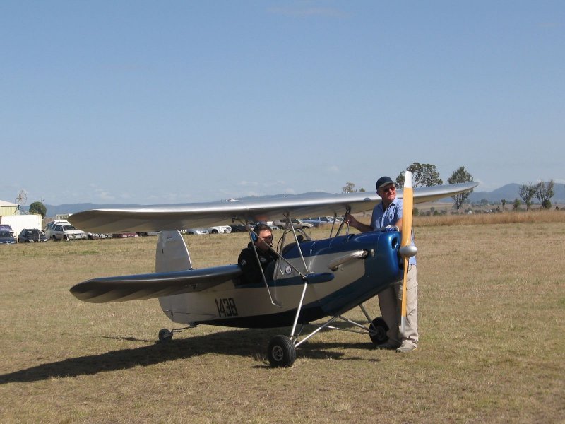

paddo2002 Posted August 6, 2016 Posted August 6, 2016 I am the current owner of the HM290FB of which Kasper speaks. It flies very well. The plans for this aircraft are freely available on in the internet at Pouguide.ar. It flies very well and there is video footage of me doing it at youtube. search Flying Flea at Watts Bridge. Where about are you Scott? If you want any photos of a completed one, just contact me. Cheers. 1 1

paddo2002 Posted August 7, 2016 Posted August 7, 2016 This flea is the HM290FB that Kasper speaks of. It is fitted with a Rotax 503 and a 62 inch prop. Plenty of power and Kasper and I have both been on the heavy side when flying it. No CofG troubles or shortage of power getting us in the air. It is one of two that Fred Byron built. The other was an HM14 which Fred reconditioned and Kasper had the honour of testing them both. Crosswind landings are as Kasper described, a nonevent. This flea also has the howell spoilers and Cossandey Flap. Neither of which I use regularly. It cruises at about 65kt indicated and I am more than happy to answer as many questions as can be thrown my way. By the way, nice Minimax. I have always like them.
kasper Posted August 7, 2016 Posted August 7, 2016 Nice polite way of saying we are both fat bastards ;-) FYI Howell differential spoilers allow you to drop a wing into wind to assist with cross winds but as Paddo points out there is not a great deal of need for them - wide runways and slanted landings suffice - if it too windy for standard landings then generally its a nice day to sit on the airfield and talk bull dust with the rest of the people. Cossandy flap is a negative flap in the rear wing centre section that is primarily designed to dump lift from the rear wing to pull out of a vertical dive - it was designed to overcome a reversal of pitch control on the tandem wing when there is insufficient aerodynamic gap - the HM290FB has one of the worst set ups on any flea - there is nearly overlap of the wings and we fly it at extreme rear CofG per some peoples calcs and even when in a near vertical dive tests at over 120kts full back stick could not trigger control reversal so it can just be used more as a trim device to use when doing extended slow flight but thats not common so not really essential in my opinion. 1
