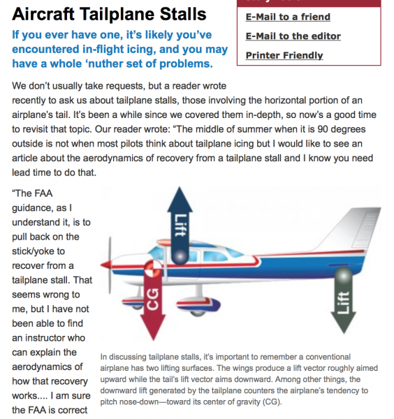

Garfly Posted August 20, 2016 Share Posted August 20, 2016 This recent article on tailplane stalls is not all that relevant here ... but somewhat: Aircraft Tailplane Stalls - Aviation Safety Article 1 1 Link to comment Share on other sites More sharing options...
